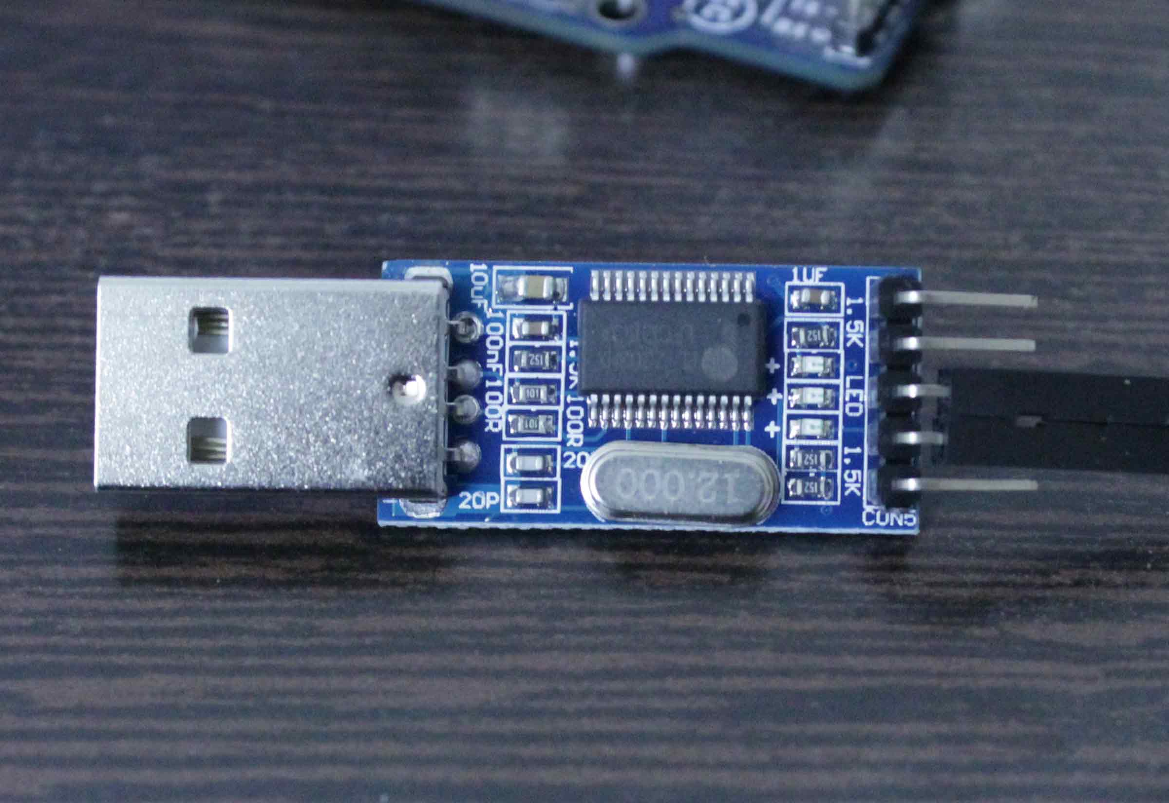

HI Friends,
I have prepared a board to work stand alone. I am trying to achieve communication between computer and my standalone Arduino. I have attached pics of the USB RS232 converter that I have. My question is how to connect the USB serial to Arduino stanalone. I assumed that TX from USB to RX of ATMEGA and RX from USB to ATMEGA TX would work. I am trying to control 3 LED's from my computer. With the connections above All the LEDs start blinking randomly. Not sure whats wrong. Below is my code.

[RESOLVED]
Found the solve. Just had to ground from USB to serial converter.
Good catch! Yes, All signals require a common GND return. I hit the same, when I tried making a expanded "Buttons" over Network, and suddenly realized, even after trying all the suggestions I got from here, and still not having it work, that... the common power rails on a long breadboard section, were not 2 solid, but... 4...( :fearful: D'OH! )
