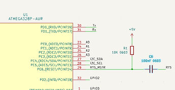

I am attempting to program a Atmega328P using a FTDI USB to serial adapter. I've done this a couple times in the past and am currently running into an issue I can't seem to resolve. On the board i have connections to pair with the adapter: +5V, GND, Rx, Tx, RST, and CST. I simply ground CST and RTS is connected to the ucontroller as shown below.
Before mounting the ucontroller on the board, I burned the Arduino UNO boot loader and programmed the desired script on the chip. Ironically enough, i do the chip programing with a different custom board with another ATMEGA328P, and use the same USB-serial adapter and reset schematic above (which is very weird).

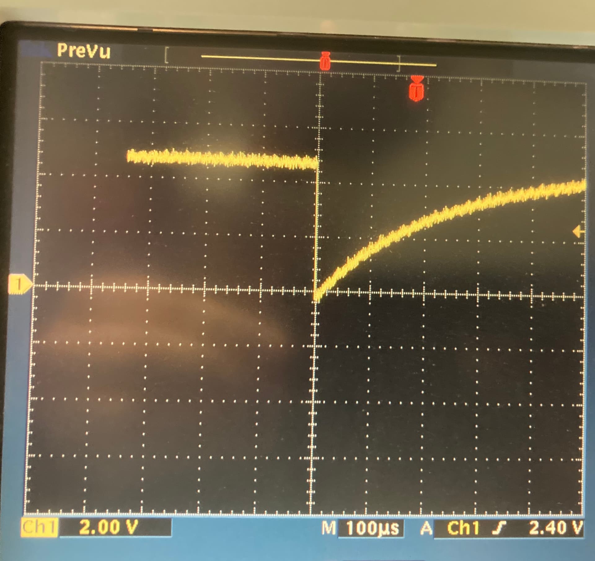

  7. Measured the reset pin as i tried to reprogram the chip
    This is the node at pin 29. It looks like the chip does get the reset signal. perhaps the timing is wrong? The datasheet says reset voltage is 0.9*Vcc. The scope is indicating almost 0.5sec before the reset pin reaches close to that value. Seems like a lot, but what do i know?
