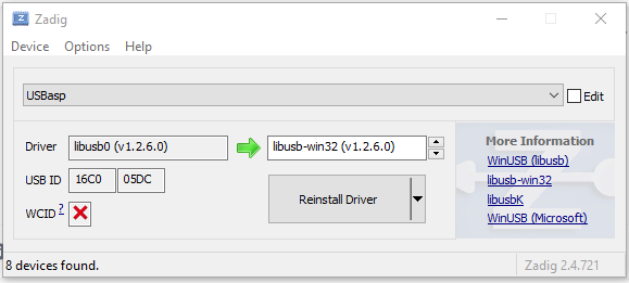

I was a happy USBasp user, until I switched to Windows 11 just a few days ago.
I'm using an USB 2.0 port for the USBAsp, I installed the driver using Zadig, just as I did under Windows 10.
In the device manager the USBasp is listed without any error:
Although only COM1 can be selected in the IDE, but I can't remember whether USBasp should have another COM port.

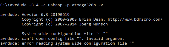

Avrdude command line is also not working:

Hi @amazed. Try using Zadig to install the "libusbK" driver for the USBasp instead of the "libusb-win32" driver you are using currently.
Hopefully the "Upload Using Programmer" operation will work after you do that.
It does not. This is a pure USB device that doesn't use serial ports at all. So it is normal and expected that you won't see a serial port in Arduino IDE's Tools > Port menu, and it doesn't matter which port (if any) you have selected at the time you perform the "Upload Using Programmer" operation.
You must specify the location of the avrdude.conf file via a -C flag in the command line:
https://avrdudes.github.io/avrdude/8.0/avrdude_4.html#index-_002dc-wildcard_002fflags
If you enable verbose upload output in the Arduino IDE preferences, then perform an "Upload Using Programmer" operation, you can use the avrdude command that is shown in Arduino IDE's Output" panel as the reference for the correct way to configure an AVRDUDE command to run directly from the command line.

After my initial confusion, I thought about the error message a bit and it occurred to me that the avrdude.conf file's directory also needs to be added to the PATH part of the environment (system) variables. The command line also works now.
