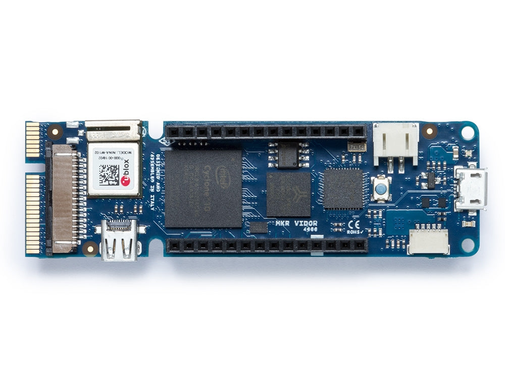

You're not giving us enough clear detail to help you, but don't have the expertise to do it yourself. I wouldn't recommend you try what you have proposed. I'd go with something like this myself.
If you need Lots of computing power , some interfaces and GPIO, you should just go with a SBC. Or a FPGA? Or a really powerful MCU.
