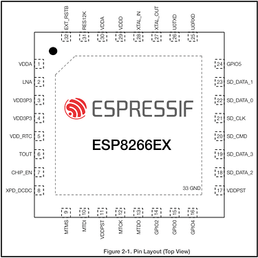

Traditionally, Arduino pin numbers are only arbitrary identifiers for a pin, completely abstracted from the low level pin identifiers to which they are mapped by the core variant code. The core functions take Arduino pin numbers as parameters and then derive the associated low level identifiers from the Arduino pin number.
The developers of the "esp8266" core took a non-standard and confusing approach to pin mapping where they made the Arduino core API use the low level GPIO numbers, then used macros to map the pin numbers/names as marked on the board silkscreen to the lower level GPIO number. So indeed the numeric component of the macro doesn't necessarily match to the GPIO number when using those boards. For example:
- static const uint8_t D2 = 4;
When using one of those boards, I do recommend using the macro simply because this is the only way to have your code match what is written on the board's silkscreen.

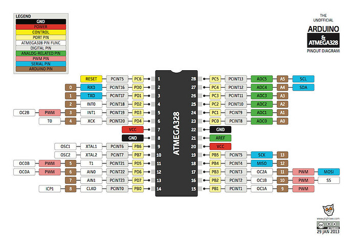

The D1, A2 etc. identifiers correspond to board pins. These pins then are mapped to controller pins and finally to controller ports and pinmasks.
This allows to e.g. develop code for an ATTny custom board on an ATMega.

They are the identifiers for the IO pins on the microcontroller:
If you have worked with the AVR microcontrollers, you might be familiar with the low level pin identifiers like "PB5" (port B, bit 5):
The GPIO number are the same thing. The manufacturer of the chip simply chose a different format for the identifiers.

I am confused by what best practices would be for how to reference the "A" pins.
Here we are stuck with the unfortunate decision the developers made 20 years ago. The silkscreen on the board says "A0", and that is not reliably equivalent to the integer 0, so the only reasonable approach is to use A0 in your code.
