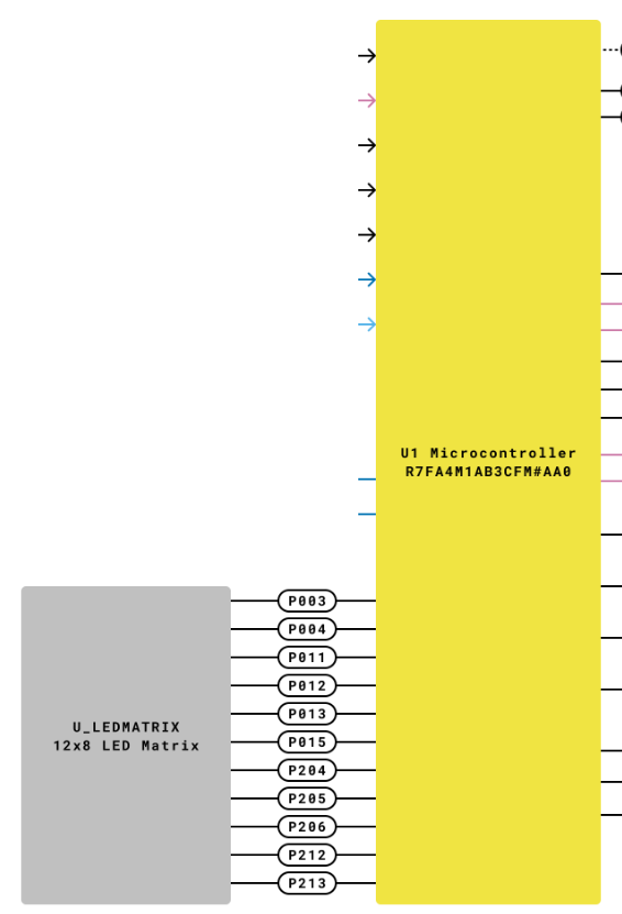

From what I read, no direct port manipulation as with the ATmega328P... but someone wrote the library which eventually talks to the hardware driver... maybe low level libraries will divulge the info...
The UNO R4 WiFi has a similar/equivalent connection between the Renesas RA4M1 and the matrix:
But the question remains: how to manipulate the mode and value of the pins P002...P213?

You can use pinMode and digitalWrite if you like. The pins on the RA4M1 connected to the matrix are mapped to Arduino pins:
Here is a simple sketch to blink LED 1 in the matrix:

Those are the identifiers for the Renesas FSP. You can use them with the FSP functions, but you can not use them with functions that take an Arduino pin number as a parameter. The g_pin_cfg array from which the snippet in my previous post was referenced is the mapping between the FSP identifiers and the Arduino pin numbers. The Arduino pin number is the index of the array.
The LEDs are connected via "Charlieplexing", which means that to light "all" of them (or even "more than 10" of them), you need to dynamically change the values of the port at a rate higher than the persistence of vision limits.
Charlieplexing is explained here: https://www.instructables.com/How-to-drive-a-lot-of-LEDs-from-a-few-microcontrol/ (among other places.) Basically, to drive a particular LED, you set the pin connected to its anode HIGH, the pin connected to its cathode LOW, and set all of the other pins to high-impedance (ie INPUT) You should be able to light up 10 LEDs at a time by setting 10 pins HIGH and one LOW, or vis versa, but they may not be "conveniently located.)
The R4 WiFi apparently uses a total of 11 pins to drive the array, so it could theoretically drive 110 LEDs , so some of the 10-at-a-time combinations won't have all 10 LEDs.
This label depends on two physical items, the intended port and pin number. Using this label requires two lookup tables, for the port address and pin mask. This implied code has to exist in your firmware and has to perform both lookups.

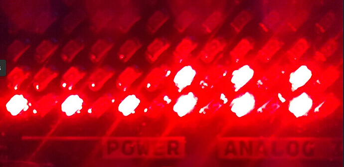

OK, I found something unexpected, and would appreciate any assistance provided in coming up with an explanation.
In my tests, all pinModes for digital pins 28 – 38 (LED Matrix Pins 0–10) where set to OUTPUT, and all pins were initially set HIGH (which extinguishes the LED matrix, as expected).
The following code works as expected:
digitalWrite(38, HIGH);    // ROW09
digitalWrite(37, LOW);     // ROW10
The result is to turn on LEDs 91, 93, and 95 in the 8th row of the matrix.
In addition, the following code also works as expected:
digitalWrite(38, LOW);     // ROW09
digitalWrite(37, HIGH);    // ROW10
The result is to turn on LEDs 73, 75, 77, 79, 81, and 83 in the 7th row of the matrix, as well as 85, 87, and 89 in the 8th row.
Now, for the surprise:
I would have expected this to turn on all odd-numbered LEDs in both the 7th and 8th rows of the LED matrix (i.e., the union of the two previous sets of lit LEDs).
Instead, this is the result:
The unexpected outcome is that LEDs 73, 75, and 77 in the 7th row of the matrix are not turned on.
Another clue (difficult to see in the image, but apparent in real-life observation) is that LEDs 91, 93, and 95 are somewhat brighter than the other 6 LEDs.
Any takers? The schematic diagram is available here, and reproduced below, for your convenience:
The resistors are causing the unexpected result.
Resisor R16 on row 9 has the current from six LEDs flowing through it (79, 81, 83, 85, 87, 89), while resistor R14 on row 10 only has the current from three LEDs (91, 93, 95). This causes LEDs 73, 75, and 77 to have too little voltage across them to light up, and caused LEDs 91, 93, and 95 to be brighter because there is less voltage drop across R14 then R16.
