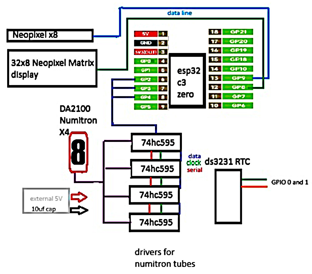

I am working on a project that I am using both AdaFruit Neopixel and Neomatrix.
For the Neopixel part I have a strip that turned on in the setup and used as a backlight. So it is a set and forget, but I would like to be able to have the flexibilty of changing the color/brightness down the road. The Neomatrix is connected to a 8x32 WS2812 display for scrolling messages. running on a Waveshare esp-c3zero, using different GPIO's to control 2 led segments.
The issue I have is when the sketch starts, the backlight comes on as expected, but when the matrix starts a second later it turns off the backlight.
I am almost certain the sketch is ok, I have tried various different variations of calling the backlight with in the sketch. But I am not a great(or good) programmer, so maybe I don't know what I don't know. At best I can get the backlight to flash if I put in it the matrix loop.
So knowing that the Neomatrix uses Neopixel - is this the expected behavior? or should I be able to run the 2 LED's in tandem?

We need to know the details of "it"
You can certainly control 2 Neopixel strips in a single sketch but the devil is in the detail of the hardware and software
It is totally impossible to tell unless we see if you have made any mistakes combining the two working sketches.
Or if you have made any fundamental mistakes in the concept of what you are doing.

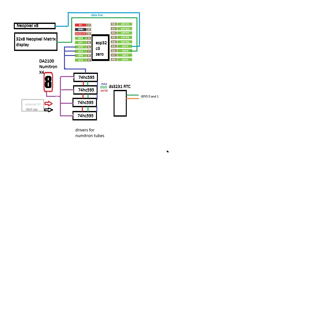

ok so here is the project - code and sorry I had to do a block diagram for the schematic.
I built the sketch with tabs so the tabs are called out in the code listed here.

For those of us with vintage eyesight...
That is not the way to wire up neopixels. You have no series resistor, nor any capacitors on the output.
see The Magic of NeoPixels | Adafruit NeoPixel Überguide | Adafruit Learning System
You have multiple programs in one code block. Please, put each in its own code block.
