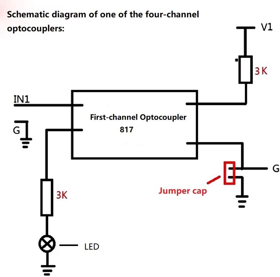

Heres a look at the pc817 board i have. in this configuration it sems to work okay at 115200 baud. If i try 500000 i only get part of the message. Do you think i could get this circuit to be compatible with 500000 baud?
Does using the 3kohm resistor put me in the 200khz operating range of the pc817?
Do i need a much smaller resistor? could this even work at this speed. do i need to reach the 500khz to obtain that speed?

but you could try reduce the current limiting resistor some more(to 470R and remove the LED.
The nano can handle up to 40mA per pin, and really you are lighting up an LED inside that PC817
The pullup is a different matter, that can be probably be reduced to 100R, which would result in 50mA, but that does not come from a pin, but just from 5v power and doesn't sink that current either. The table must be referring to the pullup resistor, since i doubt that with a 10k limiting resistor, the circuit would work properly, but where did you get that table, it is not in the datasheet i found.
I got the tables from post 2. I saw similar tables in the datasheet.
It seems to be working most of the time at 500000 baud. I was concerned if I replace the limiting resistor I might burn out the optocoupler.
I know the message is sent faster at 500k baud but if i remove the limiting resistor and the srduino freezes on a tx event with a 100ohm limiting resistor, would this pretty much destroy the led in the optocoupler?
As stated, a 470R resistor would be fine, I would not try with anything bigger than 1K
I am suggesting you use a 100R (or220R0 pullup on the output. 100R as a limiting resistor is to small, resulting in a current of more than 40mA which will burn the Nano's TX pin (though i think the PC817 will probably survive with a maximum current of 50mA, but only just.

from this schematic,
on the input side i have ground going to tx of arduino nano pin. i have in1 connected to 5v. if i connect v1 to rx on the other arduino and gnd to gnd then nothing is working. if i install the jumper cap then i start getting messages on rx arduino but it deletes the isolation possibility.
I'm trying to research on this but im not having any good luck so far. can someone help me out here pleasee
for whatever reason i cannot understand what im doing wrong. after all there is only very few components here. When tx send a message the pc817 led illuminates. but without connecting the ground from both boards together i cannot get the message from sending side of the optocoupler board.
To get opto isolation, each Nano needs its own independent DC supply. I would reduce the value of the IRLED resistor to get more current transferred and higher speed.
