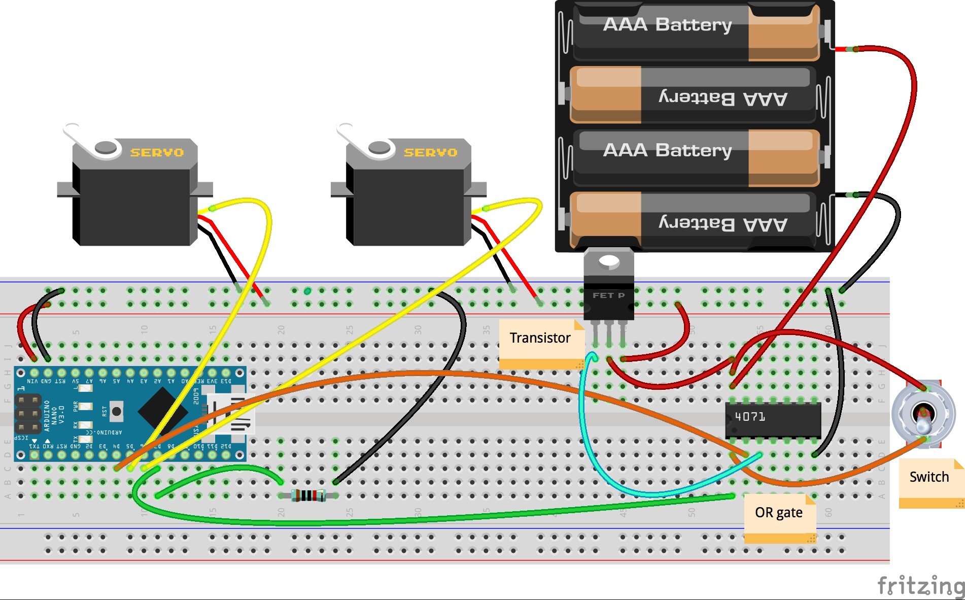

Here is the above-described setup:
My idea is to modify this setup to only have one switch, on the top of the useless box. The user would close it, and it would distribute power to the setup. When it is opened (by the servomotor), the power should not be interrupted, so that the Arduino board can continue controlling the servomotors, keep its variables in memory, etc..
To do so, I use two new components:
  • 1x OR gate
  • 1x transistor
The switch, closed by the user, now sends a 1 signal to one of the inputs of the OR gate. As a result, its output goes to 1. This output is connected to the grid of the transistor, which controls the power distribution to the Arduino & to the servomotors.
As the switch will be opened by the servomotor, another way of controlling the power is needed, otherwise it would be interrupted: As soon as the Arduino is powered, it will apply a voltage to the other OR gate input, so that if the switch is opened by the servomotor, the state of the transistor remains unchanged:
The setup can now be turned on by the user "mechanically" and turned of by the Arduino "programmatically".
Hereafter is a representation of this improved setup:
The components I used are the following:
OR gate: SN74HCT32
Transistor: IRFB4321PbF
Links to their data sheets:
OR Gate
MOSFET transistor

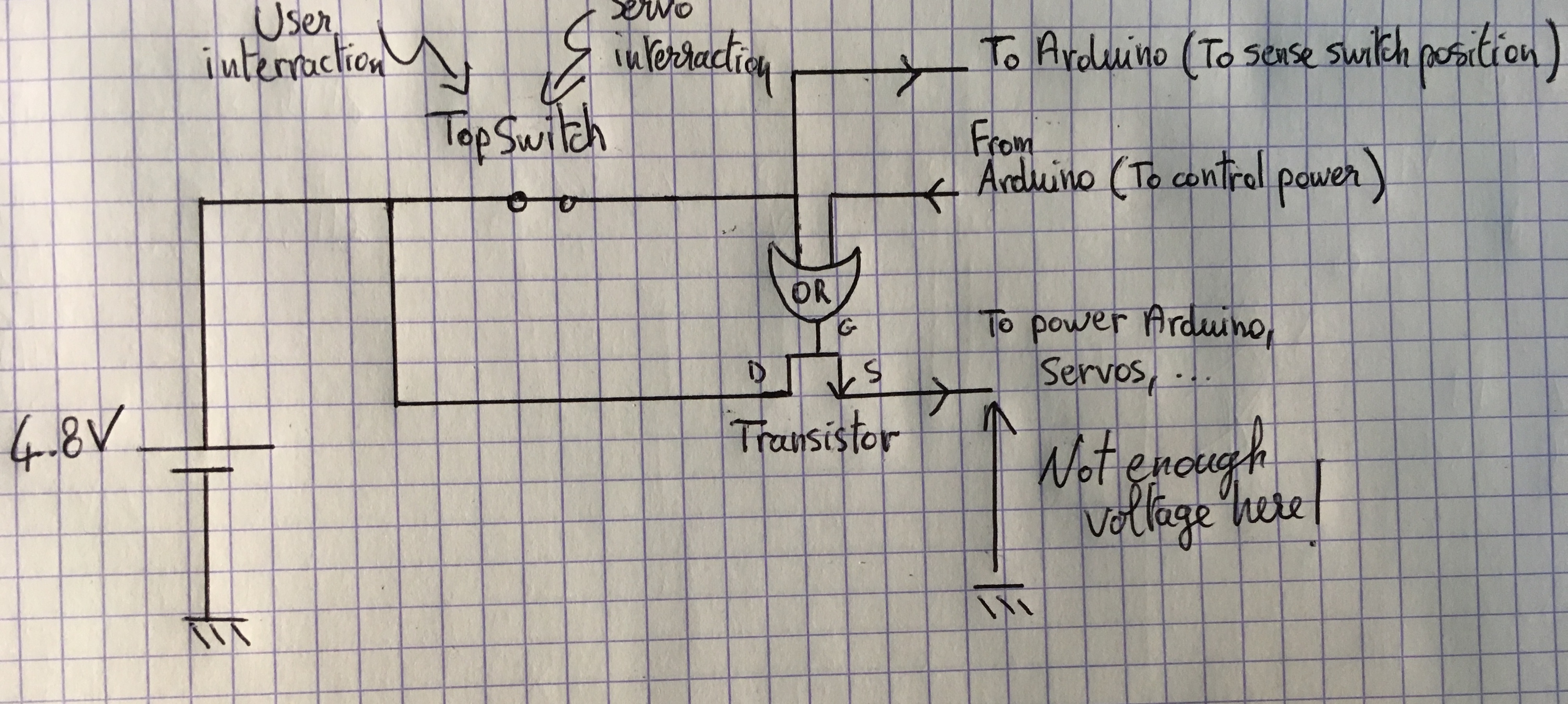

Now, here is my issue:
I don't get sufficient voltage from the transistor output.
Using a multimeter:
The OR gate outputs 5.11V when it is in its high state (0V when low), the output is connected to the grid of the transistor (this seems fair to me).
I have 3.95 V between the drain and the source. (This seems pretty high to me, as the grid is at 5.11 V).
Drain voltage is 5.11 V.
I only have 1.11 V of power available after the MOSFET (to run the Arduino & the Servos) => It won't work !
Now, I have never been an electronics specialist, and I might have poorly chosen my transistor.
Is it an issue with my setup or is it a transistor issue ? Which one should I use ? Are there alternative setups I could use ?
Your help would be highly appreciated ! Thank you very much !
Greg.

That MOSFET is probably not a logic level one. Look for IRL types.

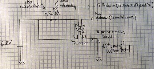

Here is a simplified diagram.
Power is applied (by the transistor) if:
  • The switch is closed OR
  • The Arduino sends a signal to keep power on
I didn't represent the rest of the circuit as I believe this is not relevant.
About the Transistor I used, I didn't know this difference between IRF and IRL. Unfortunately mine seems to be IRF (although I'm not sure about what it means). Would my setup work with an IRL MOSFET ?
You need a logic level gate or it won't switch on. Look for the VGS(th) value, this should be about 2V. Yours is 3-5V, and it's fully open at about 10V.

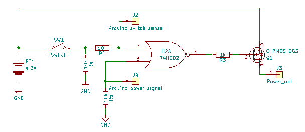

In this circuit you also need a p-channel FET, and your part is an n-channel (use those for low side switching). The symbol in your schematic is also for an n-channel FET.
Note that for your p-channel FET it will switch on when the output of the gate is LOW (0V, or -5V VGS). So you will need a NOR instead of OR gate.
This way you will connect the Arduino's pin to 5V while it is still powered off. That's a bad idea, and it will kill the pin. Adding a 10k resistor there will protect the clamping diode from burning.
The switch also needs a pull-down resistor (on the side of the OR gate), to make sure the OR gate gets a LOW level signal when the switch is open.
This should do much better (sorry, no suggestions for suitable MOSFET here - do a search on this forum or Digikey):
While the switch is open and the Arduino is off, both inputs of the NOR are pulled low (pin 2 via R2 and R4, pin 3 via R5), and the output is high, switching off the MOSFET. R3 is to limit the current rushing in to charge the gate, protecting the NOR output (usually can not supply more than 10-20 mA, depending on the part).
When the switch closes, the Arduino is still off, but R2 limits the current through the clamping diode to <0.5 mA which is safe, especially as it lasts only a very short time: until the Arduino is powered up. The pin 2 of the NOR is pulled high, the output goes low, and the MOSFET is switched on.
Now you can set the Arduino pin "Arduino_power_signal" to high to keep the power on, even when the switch goes off.

wvmarle:
I understand that my lack of voltage comes from the VGS(TH) value: the grid voltage is not high enough to have a full commutation, so I should look for a lower VGS(TH) value. I will buy a new transistor.
wvmarle:
I don't understand the reason why I should use a P-channel MOSFET + a NOR gate rather than a N-channel MOSFET + a OR gate ?
With a P-channel MOSFET + a NOR gate the low state leaving the NOR gate will allow the current to flow through the transistor.
With a N-channel MOSFET + an OR gate the high state leaving the OR gate will allow the current to flow through the transistor.
From my perspective, given the same inputs (on the logic gate), I should have the same behavior for both cases in terms of output from the transistor, no ?
Obviously I am wrong, but I would appreciate if you could explain to me the reason why using a P channel FET (+ corresponding NOR gate) is the only solution here ?

A p-channel MOSFET (like PNP transistor) is for switching high side (positive line of a battery/power supply).
An n-channel MOSFET (like NPN transistor) is for switching low side (negative line of a battery, GND of a power supply).
Also the gate voltage has to be handled accordingly.

Thank you very much ! It reminds me of something at school when we were designing logic gates from transistors, now I see what you mean.
So I will buy a new P-Channel FET with a low enough VGS(TH) value, and a NOR gate.
