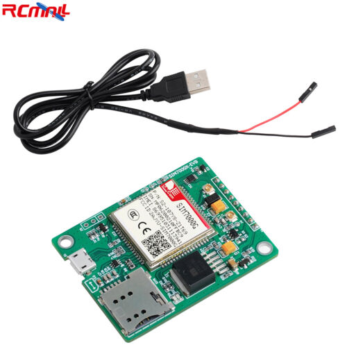

Which exact GSM are you using? Does it have resistors in-line with the Tx/Rx lines?
I'm using a sim7000 module from diy malls.
As far as I can tell there are no resistors inline with Tx or Rx lines.
Here is the schematic I have for it:
It looks like the communication is going through a level converter, but I'm unsure what IC1 in the schematic is exactly.
