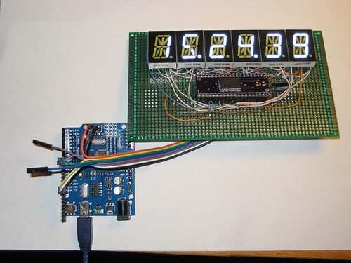

Here are a few posts I wrote on driving 14 and 16 segment common-cathode displays:
Photos attached:
