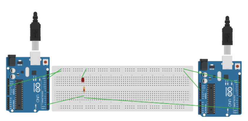

So I have 2 x 3.3v Microcontrollers that would be powered from 2 different sources. One would be powered from the wall and the other would be from my PC USB.
I would like to interface the microcontrollers so they can talk and work with one another by hooking them both up directly to each other and hooking them up to components on a breadboard.
The thing that concerns me is the separate power sources as I really can't afford to have them damaged. I did a simulation on TinkerCAD and in the simulation it showed that no matter how I wired them or used them it never caused any issues. However simulations are not reality.
A bit of poking around on Google showed mixed ideas, some said it would be perfectly ok and some said I'd have to a special setup or have special components or something of the sort.
Basically I decided to just ask on here if anyone can help me with this. I'm sure it's a very basic and beginner question but any help would be appreciated, thanks in advance.

Apologies for vague information:
  • Microcontroller 1 is an Arduino Micro (Powered via USB)
  • Microcontroller 2 is an Adafruit Metro M4 (Powered via wall outlet)
I'm playing around with different ideas and just want to work with leveraging 2 microcontrollers to do different things. I really don't have anything specific in mind. Here's some rough ideas I want to play around with:
Idea 1: Hooking wires up directly between microcontrollers like such to do whatever I can imagine. In this image I'm hooking up 2 wires, one to digital and one to analog to tryout different inter-microcontroller communication on analog and digital for learning purposes and expirementation.
Idea 2: Having a breadboard with some components on it, whatever they may be. In this example it's an LED light which is useless in and of itself but serves as a ground to see if a component can electrically handle 2 microcontrollers controlling it at the same time.
In Example Two the microcontrollers also both power the breadboard.
Idea 3: there's more going on, 2 micro controllers are powering the breadboard at the same time and their interacting with an and gate to power 4 led lights conditionally depending on the outputs of each microcontroller.
These are just random ideas I have, I could spend literally all day coming up with different ideas and setups. The entire point of the question is just if having 2 different 3.3v currents, one from a usb and the other from a wall, will (in whatever setup I do) cause components to be damaged because there's 2 currents flowing from 2 different sources.
NEVER connect two outputs together.
NEVER connect two positive power supply lines from different power supplies together.
NEVER connect LEDs to anything without a resistor.
If you do any of these three things you will damage something.
In order to let the two Arduinos communicate you NEED to connect the two ground lines together.

If your talking about image 1, based on your example and comment image 1 is perfectly ok i just need to add an additional wire for the ground?
Like this?
But the other two images are different and include a connected ground, are they correct?

  • The image posted is one that I quickly mocked up because it was requested on here. I'm aware the Arduino can only read on analog and analog write on certain pins capable of doing a write. This was a mistake in the mocked image.
  • I'm aware LED's require a resistor, this was a quickly mocked up image because it was requested. I'm not actually going to place LED's down without a resistor attached or really much of any components without a resistor.
  • I'm not linking two 5v currents, I'm linking 3.3v currents but it's interesting that I wouldn't be able to link 5v currents. Why one and not the other?
NO - because they connect the 5V lines together. This will cause damage.
What happens if you connect two outputs together is that as long as the two outputs are the same things are fine. But when one is HIGH and the other is LOW you will damage the pins.
You can't change two output pins on two different processors at the same time.
Read what I said about the analogue pins, and digital pins not both being outputs. If one is an input and the other an output then things are fine. If you must do this then put a series resistor of about 330R between the two pins for when you inevitably make a mistake.
I added an edit because I didn't see your edits, I'm reading through this information right now.
No you can't link any supply voltages no matter what they are.
I do this in one project where two processors are sending semaphores to each other. I haven't damaged an I/O port yet.
put a resistor between the conflicting pins - to limit the current.
it’s the current that kills a pin.

As Grumpy said, "No you can't link any supply voltages no matter what they are.". You can power each board with its own power source, but if there is any communication between them, either through I/O pins, I2C or Serial ports, they must have a common ground.
Just don't let the + of the power sources touch each other.

I have to disagree. You can safely connect IO1 to IO2 and set IO1 as input and IO2 as output. You cannot hurt the input pin this way because according to the Atmega datasheet, the Arduino pins consume pretty close to zero input current. From section 26.2 DC Characteristics:
Input Leakage Current I/O Pin low = 1 uA
Input Leakage Current I/O Pin high = 1 uA
Current doesn't kill the input pin. It will draw only the current it needs. But trying to suck more than 20mA from an output pin can kill it. (Like driving a motor or solenoid directly from the I/O pin, or accidentally connecting it to ground.).
The resistor is a good idea in any situation where the pin states could become unknown !
Connecting inputs together won’t cause a problem, but if you accidentally tie an output to any driven pin or supply rail is fairly certain to cause problems over time.
