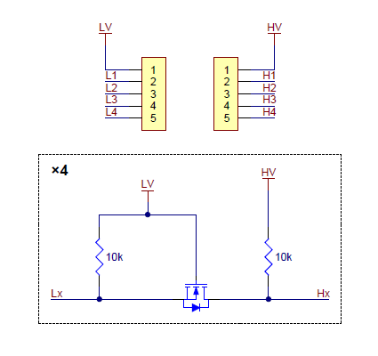

I'll try the experiment - but am still confused on why the high voltage connection is necessary. Here's the circuit:
Hx is driven either high or low by the 5V TX, right? So why would HV need to be connected?

You are correct (with the exception noted below). I had the HV and the LV swapped in my mind. I am sorry.
Professor Chaos wrote (in part):
Exception: Prior to the pinMode() function being run for this pin, the pin connected to Hx will default to the INPUT state on some (all?) Arduinos. It could float to any voltage from 0 to 5 volts. Connecting 5 volts to HV will prevent this issue. If you can ignore the result (which could be some transitions from high to low and back) on the Lx side during this time, all is well. Note that you could do the equivalent at the Arduino if you have a roughly 10K resistor available.

When Hx is low, Lx is driven low through the FET. A pulldown resistor is unnecessary and will form a voltage divider with the pullup resistor that is connected to 3.3 volts.
