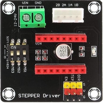

Ran into a snag last night. In order to make the clock quiet enough I am using a TMC2209 clock driver chip. It is mounted on a breakout board that looks like this
driver board
Notice that the micro stepping is controlled by three small slide switches. In my past experience when all switches are off the chip send pulses to the motor on a 1:1 basis. So I set it up to do 10 pulses per second which should translate to 3 RPM. To make a long story short I have to send approx. 80 PPS to get 3 RPM.

The TMC2209 has only 2 pins to control the microstepping. Microsteps can be x8, x16, x32 or x64 (see here, Fig. 6) with the 2 MSx pins. Or you can set the microstepping through the UART.
Yes. I was able to get the motor to go at 3 RPM by setting the output to 80 steps per second.

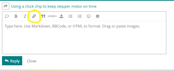

Another question. I uploaded the data sheet for the TMC2209 but it is not clickable. What am I doing wrong? I used the upload feature.
For a large file such as a datasheet, it is better to use the "Hyperlink (Ctrl + k)" button, and add a link to where you got the datasheet from.
The image above was added using "Upload", but I would use "Hyperlink" to add a link to the datasheet:
TMC2209 Datasheet.
I think the Discourse software didn't add the datasheet using your method as it would have to print an 83 page datasheet in the post. (It does say that it is 1.8MB - my image was only 22kB.)
