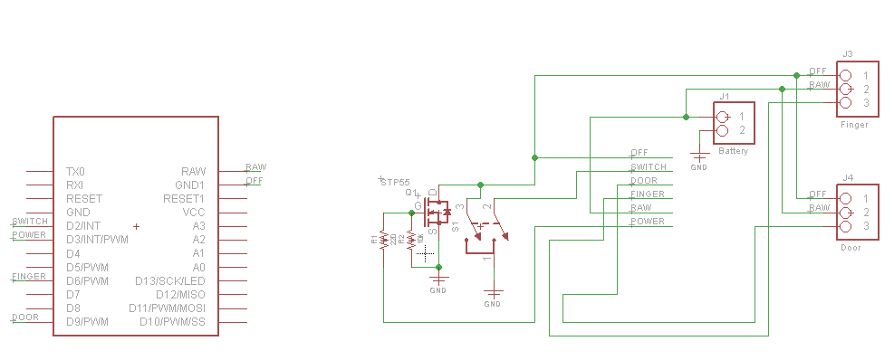

Can you give us a schematic to show us how you have got your MOSFET connected, please?
A hand drawn circuit diagram / schematic is acceptable.
So Arduino ground is connected to the drain of the mosfet.
The pin protection diode of the power pin (gate) won't allow the power pin to go lower than ~0.65volt below Arduino ground.

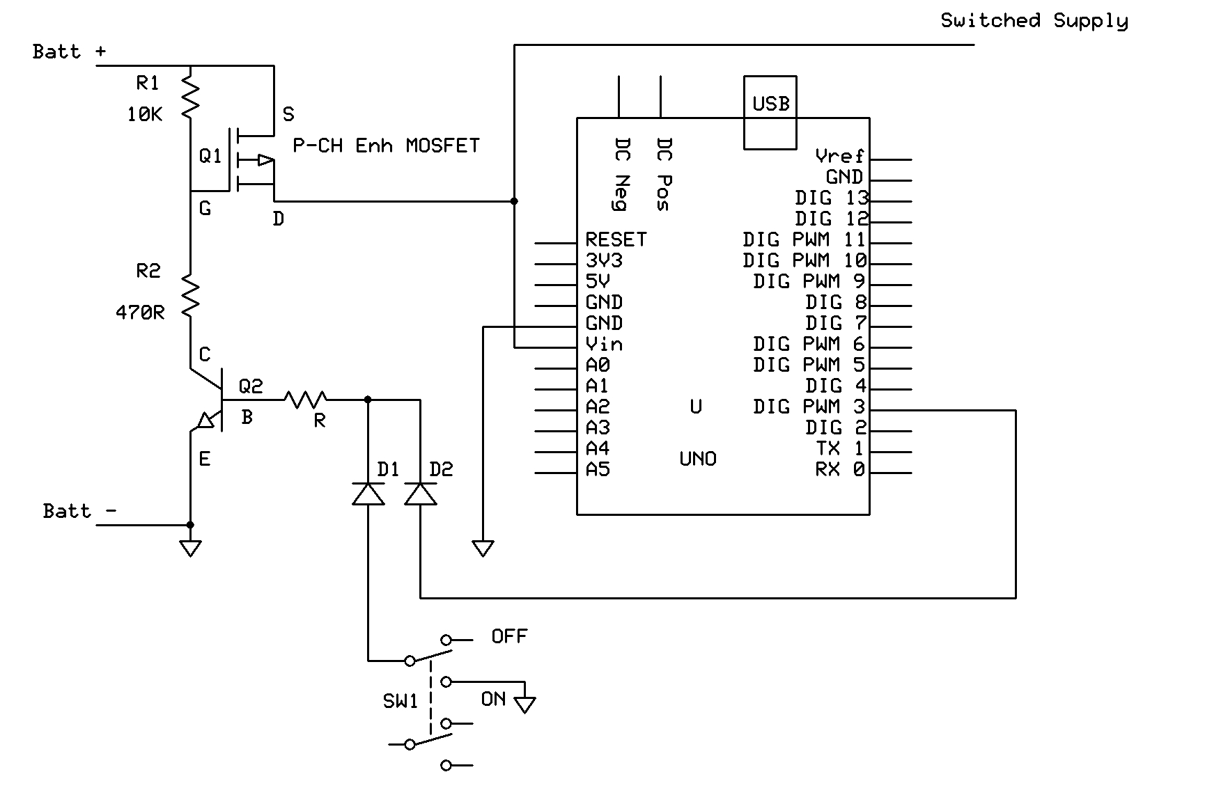

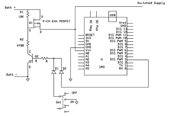

You need as advised to switch the positive supply.
I have just drawn this up as a concept to accomplish what you need,
I have one problem with your schematic, you can with proper layout CONNECT ALL the components to the UNO with wires, just labelling wire ends at the component and at the UNO does not help to trace signal flow.
Hope this helps.. Tom.. :slight_smile:
Thank you so much, that's what I'm looking for. :slight_smile:
An observation... Correct me if I'm wrong please,
D1 & D2 protect the arduino pin?
Sorry about my drawing. The arduino was originally connected by a 6 pin jumper that I deleted to put it all on one board. :confused:

Yes, as the arduino pin is an output, the diodes OR the two levels.
Tom... :slight_smile:
Tom, you have inadvertently shown the on switch connected to GND, it aught to go to Batt+.
Maybe easier to remove the diodes (Arduino pin via 10k directly to base).
And use the switch across the transistor (collector/emitter).
Leo..
