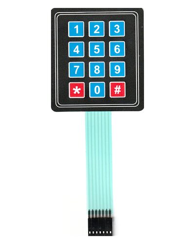

  • Suggest you use a new inexpensive 3X4 keypad.

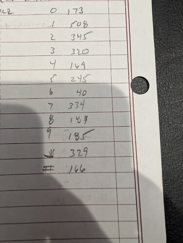

So I do have the matrix worked out, however, there was no continuity. I was able to get a resistance for each so I do have all of the wiring figured out with the keypad. But when I would press the buttons, I would get sporadic data.
You are correct, it would be simpler, however...I am trying to utilize this phone to enter a key and although it is pushbutton, it is in the same shape (round) as a dial phone.

yes, I have that figured out, however, there is a resistance for each number/key pressed. These were the measurements in ohms.
Then you can/could use analogRead()
That's probably normal for a keypad of this type. Might help to clean the contacts. But there is enough current to drive a digital input.
Yes I think any of those resistances would still pull a digital input_pullup pin "low" when pressed.
