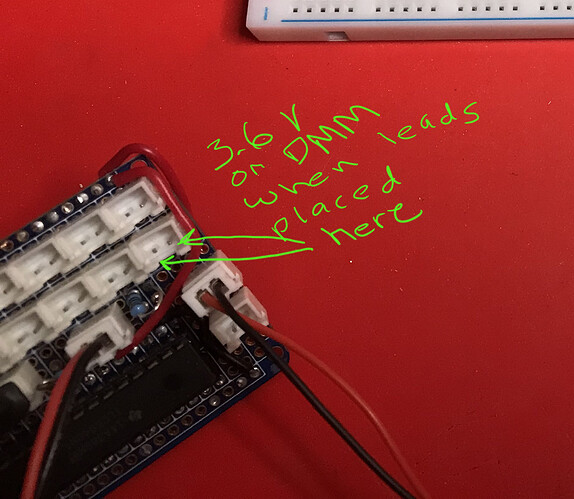

breadboard setup
OK, but it does work. Does that mean there's something else wrong? Or perhaps I've wired things backwards?

Then could you please explain why it's lighting up the LED Strip? Can you please explain why when I plug in the other SMD leds, that they all light up? How is this rubbish? I'm trying to provide as much info as I can and the best you can do is be insulting? WTF?
Data sheets don't lie (usually!). What does it say? :slight_smile:
I measured voltage using the DMM on the output pins, see the pic
