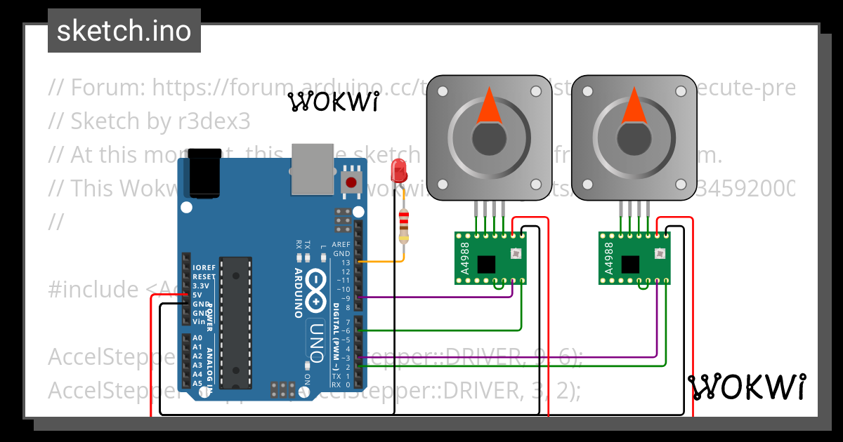

I have made a Wokwi simulation for your project:

Do you mean this?
float revPerSq = 50/(2*PI*3.81);
(This new rev calculation worked for me in @koppel's sim, but I increased the accelleration to complete the moves in the alloted time.)
Sample Code tested in Koppel's Wokwi

  StepperR.setAcceleration(100);
  StepperL.setAcceleration(100);
  startTime = millis();
  lastPrintTime = millis();
  pinMode(13, OUTPUT);
  unsigned long currentTime = millis();
  unsigned long elapsedTime = currentTime - startTime;
  switch (test[currentAction])
    case 1:
        if (!actionComplete)
          long desiredPositionR = (StepperR.currentPosition() + (stepsPerRev * revPerSq));
          long desiredPositionL = (StepperL.currentPosition() - (stepsPerRev * revPerSq));
          StepperR.moveTo(desiredPositionR);
          StepperL.moveTo(desiredPositionL);
          actionComplete = true;
          Serial.print('f');
        else if (currentTime - startTime >= fTime)
          Serial.println("Forward");
          actionComplete = false;
          currentAction++;
    case 2:
          long desiredPositionR = (StepperR.currentPosition() - (stepsPerRev * revPerSq));
          long desiredPositionL = (StepperL.currentPosition() + (stepsPerRev * revPerSq));
          Serial.print('b');
        else if (currentTime - startTime >= bTime)
          Serial.println("Backward");
          currentAction++;
    case 3:
          long desiredPositionR = (StepperR.currentPosition() + (stepsPerRev));
          long desiredPositionL = (StepperL.currentPosition() + (stepsPerRev));
        else if (currentTime - startTime >= lTime)
          Serial.println("Left");
          currentAction++;
    case 4:
          long desiredPositionR = (StepperR.currentPosition() - (stepsPerRev));
          long desiredPositionL = (StepperL.currentPosition() - (stepsPerRev));
        else if (currentTime - startTime >= rTime)
          Serial.println("Right");
          currentAction++;
    case 5:
          long desiredPositionR = (StepperR.currentPosition() - (0.5 * stepsPerRev * revPerSq));
          long desiredPositionL = (StepperL.currentPosition() + (0.5 * stepsPerRev * revPerSq));
        else if (currentTime - startTime >= halfTime)
          Serial.println("halfForward");
          currentAction++;
    default:
        digitalWrite(13, HIGH); //indicates an error (or the end of the array?)
        StepperR.stop();
        StepperL.stop();
        delay(10000);
        Serial.print("stopped");
  StepperR.run();
  StepperL.run();
  report();
void report(void) {
  static unsigned long last = 0;
  auto now = millis();
  if (now - last < 500) return;
  last = now;
  Serial.print(currentAction);
