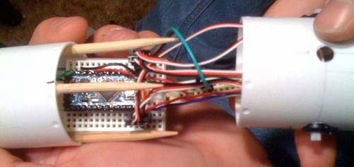

Using an accelerometer to orient a model rocket in light via control surfaces
I have attempted to recreate guiding a model rocket
Based on the linked project shown in Hack a day
I am not able to recreate their results using another accelerometer (mma 7361)
https://sites.google.com/site/airwavershr/Home/guided-rocket
link to their code download
https://sites.google.com/site/airwavershr/Home/guided-rocket/Rocket_Guidance.pde?attredirects=0&d=1
The more I examine the changes I made the more confused I get.
What I'm looking for is:
Any tips to problem areas in my code.
In addition I can display the values from the MMA 7361 successfully however I question if I'm getting accurate data.
MY modified code, uploads fine but does not zero the rockets position nor does it compensate,

This is the code I use to view the accelerometer values
#include <LiquidCrystal.h>
LiquidCrystal lcd(8,9,4,5,6,7);
int backLight = 13;
const int xPin = 1;                   // x-axis
const int yPin = 2;                   // y-axis
const int zPin = 3;                   // z-axis
  pinMode(backLight, OUTPUT);
  digitalWrite(backLight, HIGH);
  //Uncomment the lines below for Serial output
  //Serial.print("X=");
  //Serial.print(analogRead(xPin));
  //Serial.print("\t");
  //Serial.print("Y=");
  //Serial.print(analogRead(yPin));
  //Serial.print("Z=");
  //Serial.print(analogRead(zPin));
  //delay(100);
  //Comment if not using a LCD.
  lcd.begin(2,16);
  lcd.clear();
  lcd.setCursor(0,0);
  lcd.print("X= ");
  lcd.print(analogRead(xPin));
  lcd.setCursor(10,0);
  lcd.print("Y= ");
  lcd.print(analogRead(yPin));
  lcd.setCursor(5,1);
  lcd.print("Z= ");
  lcd.print(analogRead(zPin));
at rest correctly oriented I get x 303-310 y 315-320 z 336
the accelerometer is connected to 5v
