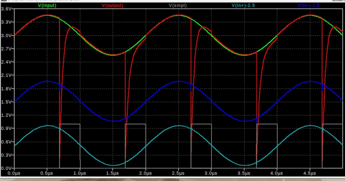

Hi
I just posted an item on how to use an analog input correctly and what goes wrong, with spice examples.
Since the question has come up a lot, perhaps it will be of use.
Please take a look, tell me what you think.
Please, mention which Arduino and which analog channel you are handling.
This will apply to any Arduino that has a SAR type ADC. I believe that means most or all of the Arduinos, and Teensys. it applies to some degree to the Sigma Delta and flash ADC, too.
The treatment is very bare bones. I wanted to make it accessible and easy to understand for someone who is laboring with the problem.
There are lots of application notes on kickback for all of the adc architectures. Here I was trying to strip it down to the bare minimum and capture the ideas in easy to understand spice graphics
So this is about the simple business of getting the right answer from your ADC and what to do about the spikes in something like maybe 3 or 4 examples.
(I mention kT/C noise, and allude to 1/f noise problems, but only in passing.)
Sincerely, give it a perusal. I think it can be interesting and helpful.

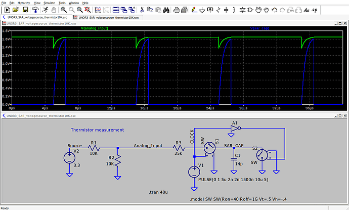

@GolamMostafa that turned out to be a very productive question.
Attached is a spice model for a thermistor connected to the analog input of the UNO R3, using parameters from the ATmega datasheet.
Notice they put a large resistor in front of the switched capacitor network. That reduces the kickback spike, and it reduces the current needed to charge the sampling cap. So that is a kind of fool-proofing for doing things like connecting a large resistor divider to a SAR input.
But as a result, (a) it takes longer to charge the sampling cap, and (b) it limits what you can accomplish using an opamp buffer or RC to drive the ADC. I would say if you need to do precision work, use an external ADC. But this is only 10 bits anyway. Still you want it to be at least accurate to something like 10 bits and not wildly all over the map.
Anyway, here is the output from the spice model. The datasheet gives a range for the resistor, I chose something sort of load mid range.
As you can see it is a solid "miss" for the sampling cap not reaching the input voltage before the end of the sampling window.
UNOR3_SAR_voltagesource_thermistor10K.asc.zip (829 Bytes)
