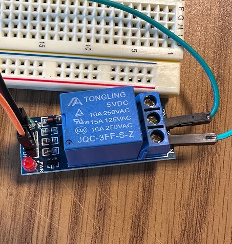

What current is the relay switching? What voltage? Pease post schematics for the relay part of the build. My fear is that a mechanical relay will worn out. Electronical switching would have a much, much longer life.
And relays are slow, and they bounce. As Railroader suggests an electronic switch would be much better.
Thanks very much for the replies... and I realized after I sent my initial post that I didn't say anything about the relay. Sorry about that.
I'm attaching a picture of the relay I'd like to use. I purchased a large quantity of this particular model because I used them in an amateur radio project for remotely switching antennas at the back of my property. I know there's a concern of them failing over time, but I've had 6 of them sitting in a PVC box through 4 winters and not a single one has given me problems as of yet (knock on wood).
For this application, the relay is powered off the 5v on the Arduino, and for testing purposes, I'm using the 3.3v pin on the Arduino to turn an LED on and off from the relay. I found a simply relay "on/off" sketch just to make some tests and to get me started on determining what I want to accomplish.
I wholeheartedly agree that the mechanical switch is a better idea, but the projector I've modified is an older model that unfortunately doesn't have a lot of room to mount the trip wire I've been using to activate the microswitch. There's a few bends in the trip wire to get over and around the inside of the projector's cast aluminum case, and I spent hours trying to come up with a design that would work effortlessly. However, with the combination of the film gate, the projector's rotating shutter, and the case... the trip wire always seems to rub against the case which causes a slight binding in the rotation of the shutter. Even if the stepper motor is able to handle this bit of additional torque, I'd like to be able to eliminate it completely.
The speed of the relay in activating the shutter release on the camera isn't that big of a deal. I can set the delay of rotation on the stepper to anything I want to allow for the relay to close. In fact, the slower the operation, the better. The one particular film I'm building this contraption for is on nitrate stock and has begun to decompose. Winding it through the projector slowly and methodically might be the best option to ensure the film isn't damaged.
