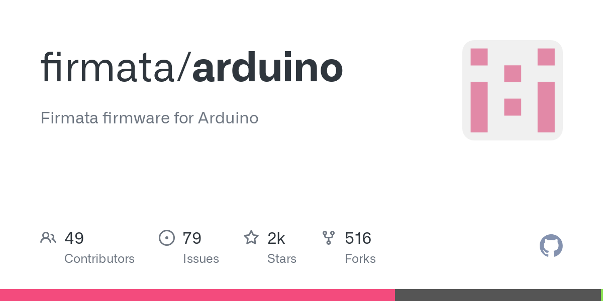

Hi @ronb1949. There is a standardized protocol named Firmata which allow controlling an Arduino board via an application running on a host computer:
That is the original Firmata Arduino library. They later created another Arduino library named "ConfigurableFirmata", which I believe is a bit more advanced than the original:
The libraries include several Arduino sketches which can be uploaded to the Arduino board to cause the board to be controllable via the Firmata protocol. So this would allow you to use the Arduino board without having to write any C++ code.
There are multiple client libraries for various programming languages that make it easier to use the protocol in the PC application. There aren't any Visual Basic libraries on the list maintained by the Firmata project:
https://github.com/firmata/protocol#firmata-client-libraries
However, I did find a website where someone shares a Firmata library for Visual Basic .NET that they created:
I don't know enough about Visual Basic to be able to say whether this might be useful to you, but I think it is at least worth a look.
