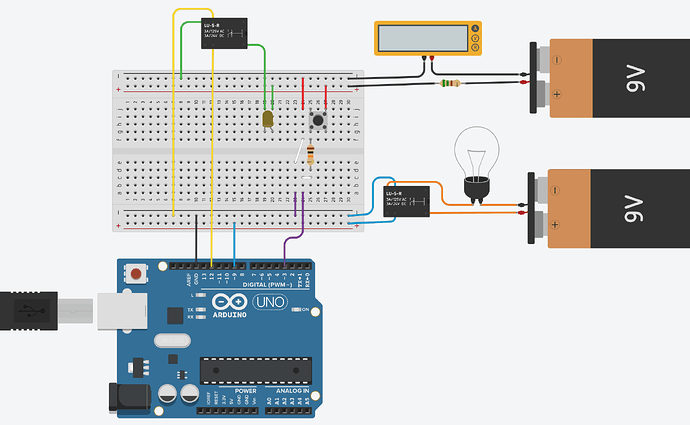

So I need to use an Arduino to detect wether a momentary switch is open or not to control multiple leds on the same hardware as this momentary switch and also to control another light. The circuit in the image is a recreation. The circuit must run on 9 volts. Right now it has a current of 13-14 mA. Here is a link to it: British Rail Class 150 Door Open Button. GWR/FGW. Great Western. | eBay
I wasn't sure about wether to use resistors or something like as wouldn't it lower the current? Thinking about using an optocoupler but I can't find one suitable for 9v @ 14mA
The white wires circled in red are the ones where the voltage should be lowered/isolated.
Sorry if my question is a bit confusing, please ask if you need clarification.

You can increase the current limiting resistor to between 1K and 10K, since the Arduino very-high input impedance..
...Or, the Arduino ATmega chip already has built-in low-current protection diodes so just a 10K series resistor should be safe.
the current limiting resistor cannot be removed as it is part of the button pcb which I can't access without breaking it, and if I were to use a 10k resistor, would it be safe to just have the Arduino and go straight back into the battery negative?
like this?
