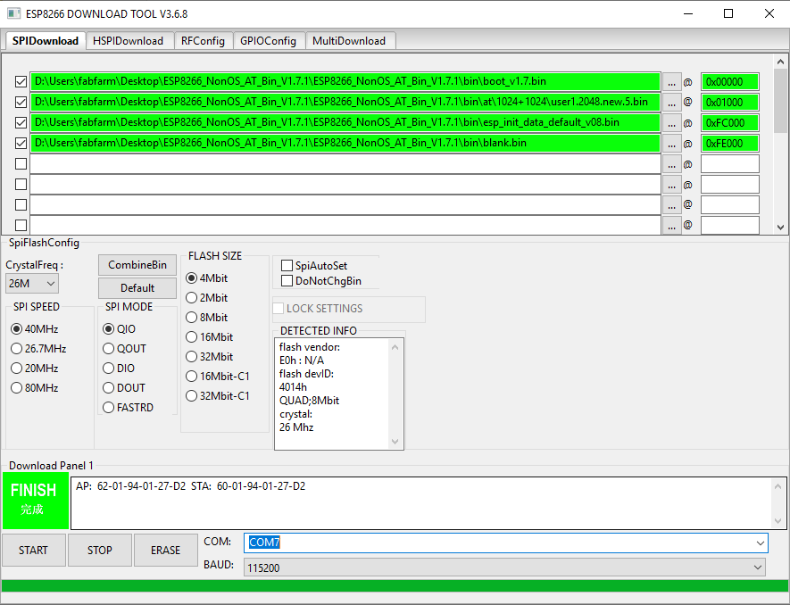

I'm using the ESP8266 AT Bin V1.5.1: https://www.espressif.com/sites/default/files/ap/esp8266_at_bin_v1.5.1.zip and the latest Flash Download Tools (ESP8266 & ESP32) V3.6.8
From the ESP8266EX Resources page, i guess i could use the latest AT firmware (ESP8266 NonOS AT Bin V1.7.1) but i don't want to risk it for now since the guide linked in my first post above uses AT firmware 1.5.1.
Anyway, the flashing seems like it went through:

Edit: I fixed my mistake. Under 'FLASH SIZE', i had selected 16Mbit instead of 16Mbit-C1. I also used the newer AT firmware 1.6.2.

the detected flash size is 4Mbit. use addresses for 4 Mbit
0x00000
0x10000
blank.bin 0x78000
esp_init_data_default.bin 0x7C000
blank.bin 0x7A000
blank.bin 0x7E000
Do you mean?
0x000000     boot_v1.7.bin
0x010000     at/1024+1024/user1.2048.new.5.bin
0x1fb000     blank.bin
0x1fc000     esp_init_data_default_v08.bin
0xfe0000     blank.bin
0x1fe000     blank.bin

So, i re-flashed the ESP-01 as per the most recent suggestion and this time i used the very latest ESP8266 NonOS AT Bin V1.7.1:

I re-flashed with a flash size of 8Mbit, reset and got the following:

Re-flashing with 16Mbit setting and reading from Serial Monitor at baud rate of 74880:

Re-flashing with 16Mbit-C1 at reading from Serial Monitor at correct baud rate of 115200:
AT
OK
AT+GMR
AT version:1.7.1.0(Jul 15 2019 16:58:04)
SDK version:3.0.1(78a3e33)
compile time:Jul 15 2019 18:12:41
Bin version(Wroom 02):1.7.1
OK
I think you need the 512+512 bin file.
So, these settings worked for my ESP-01. I hope it helps others. :slight_smile:
And the latest AT commands work great!
