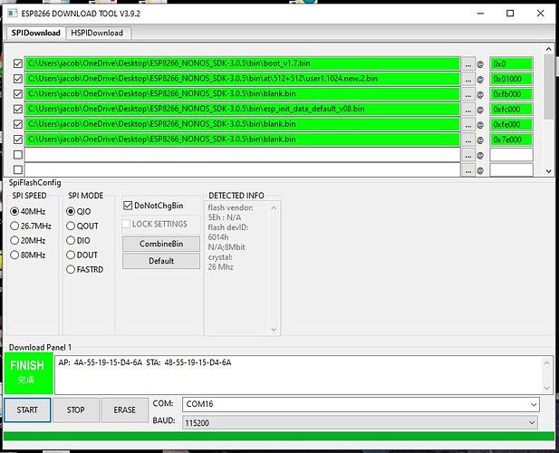

ESP8266 Download Tool V3.9.2 --
8Mb, so that's 1MB.

https://github.com/espressif/ESP8266_NONOS_SDK/releases
esptool.py write_flash --flash_size 1MB 0x0 boot_v1.7.bin 0x01000 at/512+512/user1.1024.new.2.bin 0xfb000 blank.bin 0xfc000 esp_init_data_default_v08.bin 0xfe000 blank.bin 0x7e000 blank.bin
For some esp8266 modules you will have to add --flash_mode dout before --flash_size

you can enter the parameters from the esptool command line into the 'download tool'.
did you try to open a command prompt and enter esptool.py? maybe all you need is to open the command prompt in the AT firmware binaries folder and execute the command from my previous comment

If I knew which files to pick out, to place their addresses in the Download Tool spaces, I would do that.
0x0 boot_v1.7.bin
0xfb000 blank.bin
0xfe000 blank.bin
0x7e000 blank.bin

I ran it like this --
Not knowing what to do, I placed the HEX numbers in the small red fields (where they turned green).
When I go back to TeraTerm, for the AT interaction,
it's knocking out a non-stop stream of characters.
I unchecked the DoNotChgBin box and ran it again - same result.
try DIO SPI mode
Thanks, I tried that; once with DoNotChgBin checked and once unchecked.
No Difference - a constant stream of uninterruptible 'junk'.
is the baud rate in TeraTerm 115200?
