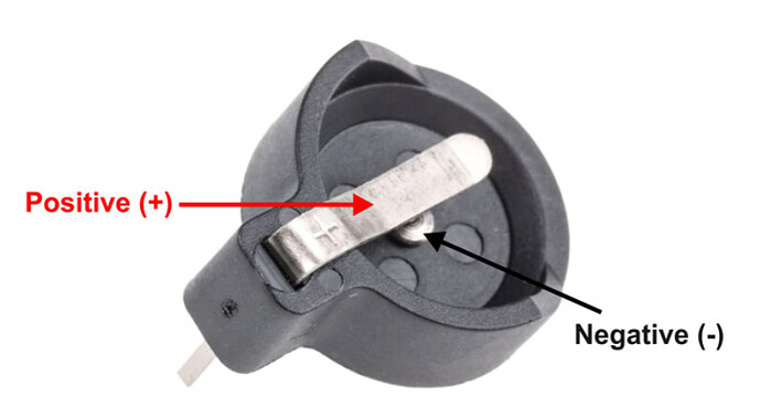

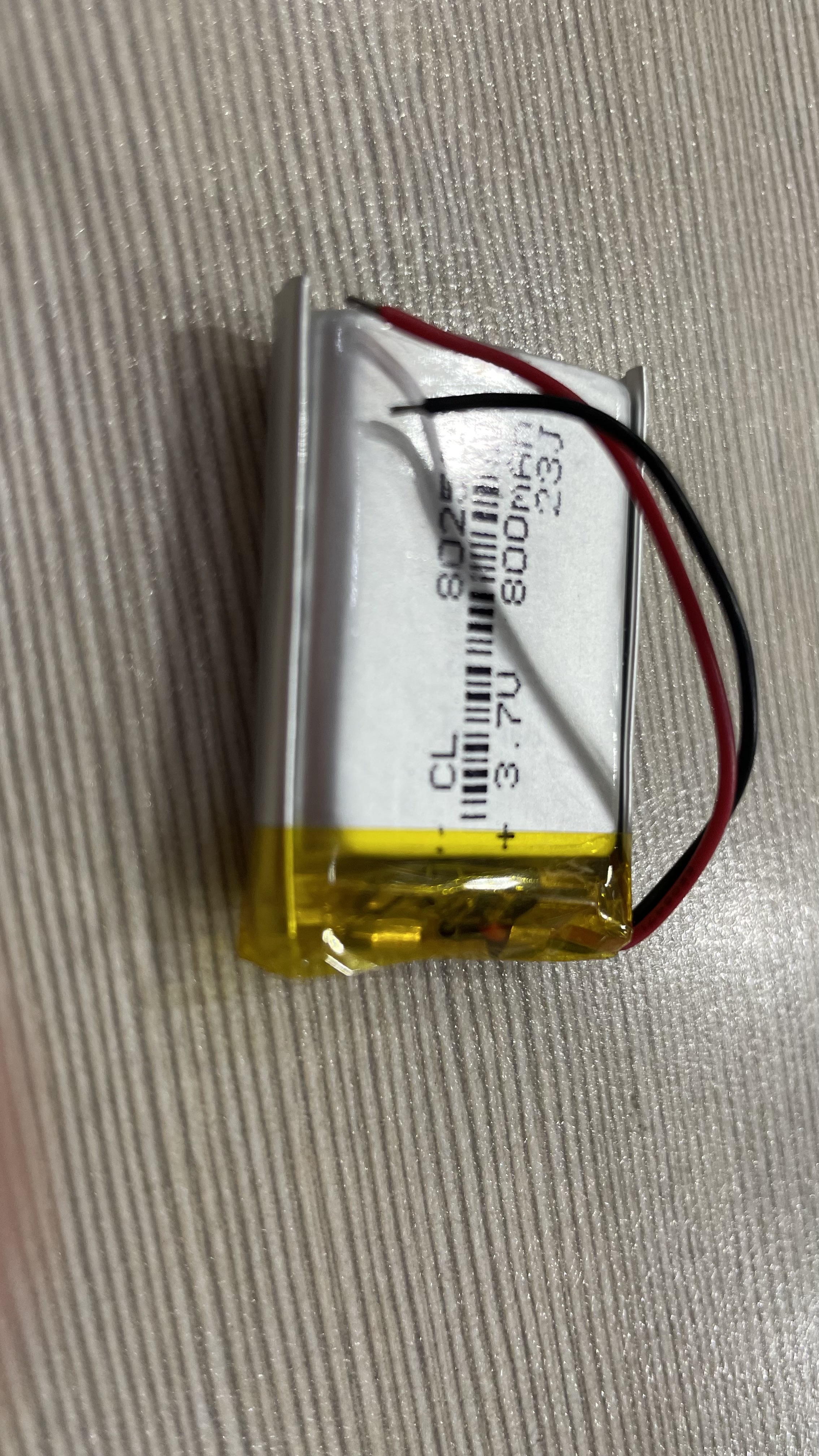

How to connect them as a supply for Arduino Nano and Esp32(not NanoEsp32)?
I didn’t find information for last photo
5x1.5V = 7.5V.
Connect black to gnd and red to Vin
Watch batteries will not supply enough current.
The classic Arduino Nano will be fine with 7.5V on Vin / GND
I would recommend to make sure beforehand that 7.5V is admissible for you specific model of ESP32
Indeed: in case of esp, 5 batteries is not the optimum...
For the Nano ESP32 the 5 cell pack will be fine. Connect the red wire to Vin and black to ground. The other battery will not work.
@build_1971, @jim-p But I don't understand how to connect if its wires are different from the Arduino wires, and the second one doesn't have one at all.
The NanoESP32 does not have wires. Exactly which Arduino are you using?
Can you show a picture or a link to the webpage?
As I said that will not work
if that were to work with your Arduino, you would have to solder wires to the pads
There is one for the + and one for the - somewhere like

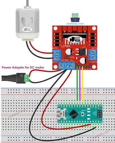

Some motor drivers will let you build the 5V you need for the Arduino from the motor power
for example like this
source ➜ Arduino Nano - DC Motor | Arduino Nano Tutorial
your battery pack would be the black power adapter in this circuit

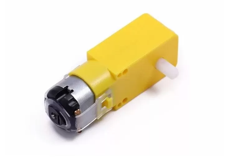

Yes, but I don’t have wires that connected to motor and battery compartment
And in this you have wires but I do not know how to connect and even recharge(according to the internet I need a special module)
You can't connect the motor directly to the battery if you want to control the motor. you'll need a driver of some sort

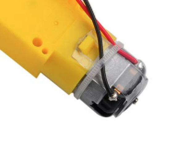

OK, so solder wires onto the motor contacts like this

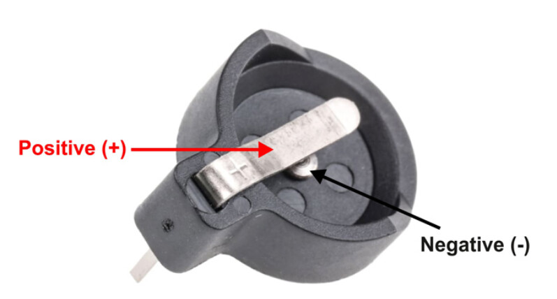

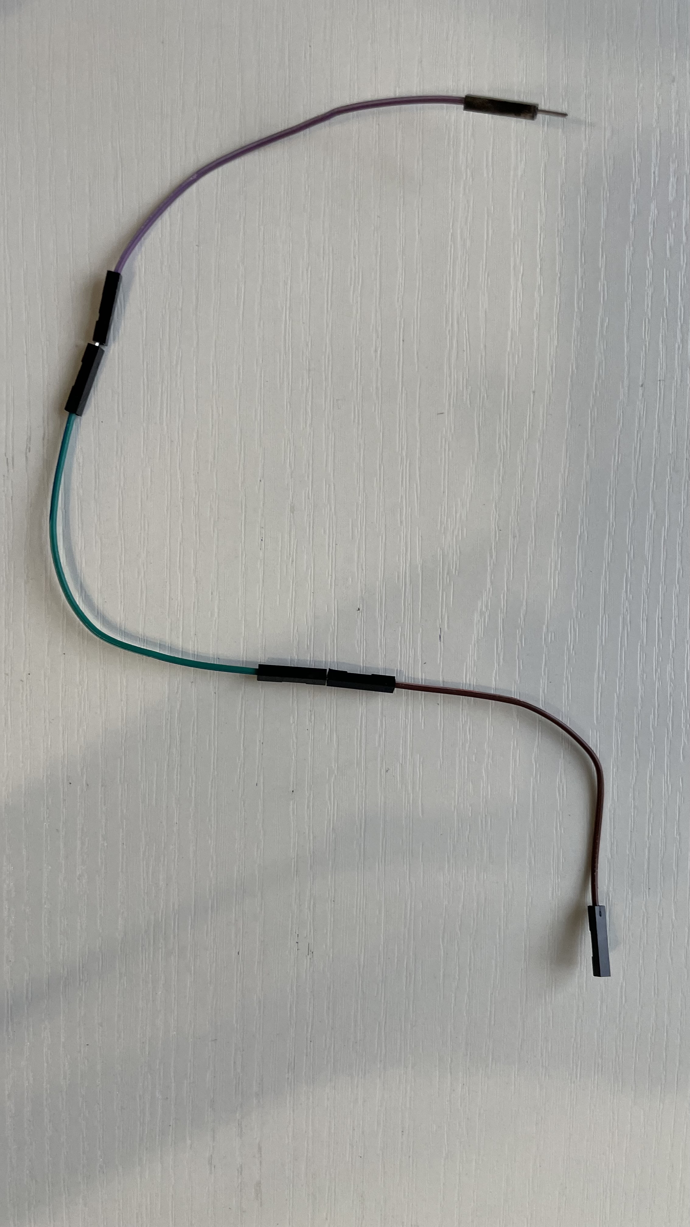

Thank You, I understand, and also @build_1971, @J-M-L, I need to clarify, I am a newbie(not complete, but still newbie) in soldering, so what wires do I need to use and why this battery pack has three contacts?
I think these wires do not fit:
:joy:
(And I was not going to connect baterry to the motor directly)
