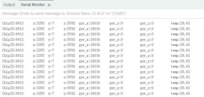

I start working on Arduino Nano BLE with BMI323, however, my output data keeps the same even though I move the IMU.
I use the code in post #13, and it works but seems still have problems.

I have solved my previous problem, by setting the address to 0x69. For those who connect to VIN, Ground, SCL and SDA, the address is 0x69 not 0x68.

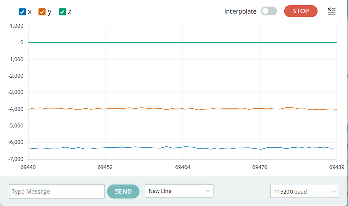

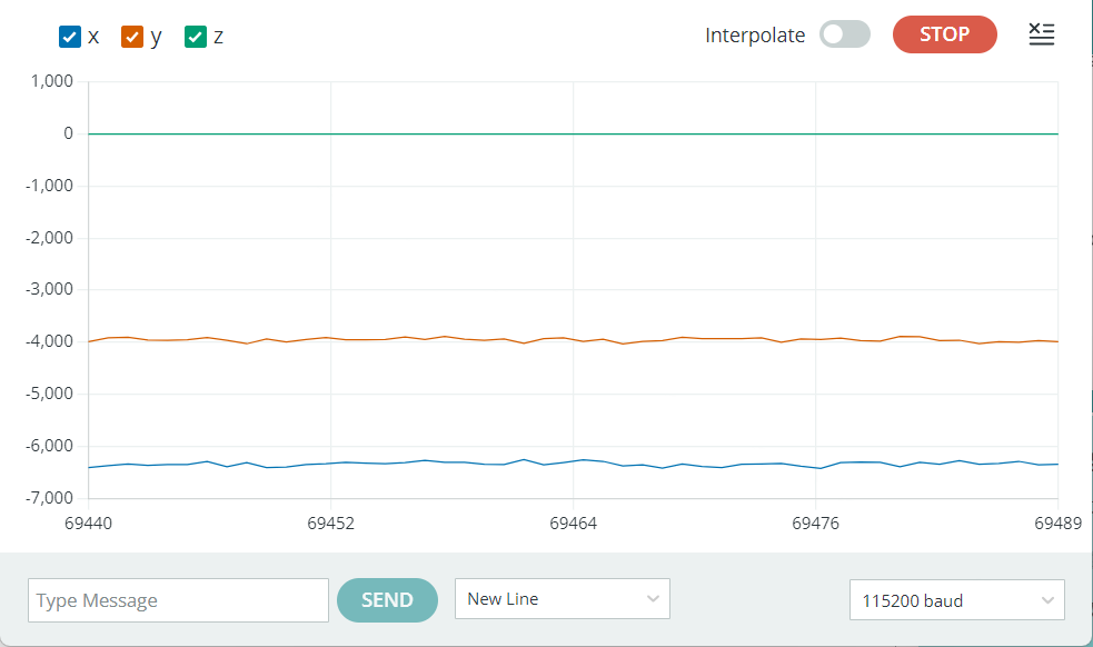

I just turned around and found some problems.
Since BMI323 supports -2g/2g range for accelerometer, it is hard to believe that the data type is "uint16_t", I try with short instead, and the results are the following:
However, although the X and Y looks reasonable, the Z always keeps 0. Are you interested in using "short" instead of "uint16_t"?
I have attached my code below:

Hi, I've tested your code and I had the same, Z frozen, but it's because you're not reading enough bytes, the 2 firsts are dummies, so you have to read 8 instead of 6 as follow :slight_smile:
  Wire.requestFrom(INC_ADDRESS, 8);
  short data[8];
  int i =0;
  while(Wire.available()){
    data[i] = Wire.read();
    i++;
  //Offset = 2 because the 2 first bytes are dummy (useless)
  int offset = 2;
And I don't see the problem to use short instead of int16_t, because it seems the same:
"int16_t is always, by definition an 16-bit signed value (−32,768 to +32,767),"
"A short is a 16-bit data-type. On all Arduinos (ATMega and ARM based) a short stores a 16-bit (2-byte) value. This yields a range of -32,768 to 32,767"
Thanks for your help. It works.
Besides, I didn't realize that you have changed to int16_t, the last code posted is uint16_t. Seems the data reading is correct now.
