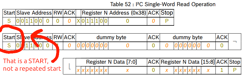

Can you write down the code to read the register ?
A register address is 8 bits ? and the registers are 16 bits ?

Yes, the register address is 8 bits and it return 16 bits value.

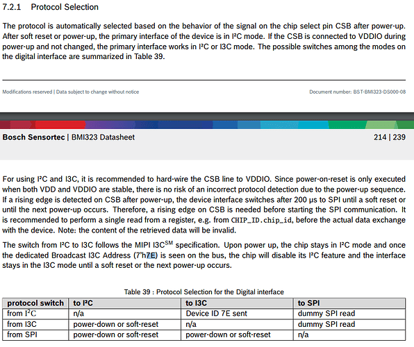

According with doc, the 0x7E is the CMD command, wich is used to configure the device before running it:
I call this CMD register in softReset() function.

It found I2C address 0x7E, that is weird. The CMD command register has register address 0x7E, that is not the I2C address.
There is either someone else on the I2C bus, or the I2C bus is so weak, that 0x7E gives an ACK somehow. It might indicate that there is something wrong with the I2C level shifter. Do you have a 3.3V board ? Do you use a module for the level shifting or did you make it yourself with components ? You could test your level shifter with a multimeter and switch SDA and SCL between INPUT and OUTPUT LOW, each for 2 seconds or so.

And without the repeated start ? Can you remove the 'false' parameter ?
The datasheet has a mistake, they say that 'S' is a repeated start, but 'S' is always a normal start.

But according to doc, do I have to read 4 bytes and ignore the 2 first ? Because it says there is 2 dummy bytes so I'm kind of lost
Your code still has the 'false' parameter for Wire.endTransmission(). Did you try without 'false' and reading 4 bytes ?
The 'true' for the third parameter of Wire.requestFrom() is never used, you may remove that.
Did you see the 'START' in the picture:
Dummy bytes ? I missed that when looking at the datasheet :open_book: Sorry.
O, they don't always show them: "For simplicity the dummy bytes are not shown in the examples below".
So yes, for I2C, there are two dummy bytes. They are zero. Reading zero for the first two bytes was correct all along.
Did you get 4 bytes and they all were zero ?
As far as I understand it, after a soft-reset or after a power-up, the registers can be read. It should be possible to read the CHIP_ID. Can you power down the Arduino board and capture the 4 bytes when applying power for the first time ? You could blink a led when one of the four bytes is not zero.
In a normal situation, a chip could be in sleep mode or could be broken or the chip is not according to the I2C standard with its timing. I'm out of ideas what to try :slightly_frowning_face:

You have both a normal STOP and START and also a Repeated Start. The sensor can probably do both.
I think my level shifter works but maybe it detect I3C broadcast Address as said P.214 of datasheet:
It's working the same with my level shifter and arduino in 5V so :man_shrugging:
Then the level shifter is working :smiley:
Meanwhile, I have been reading about I3C. Every I3C sensor should ACK the broadcast address 0x7E. If there are ten I3C sensors, then all ten should ACK. I'm not sure if the I2C Scanner can put a sensor in I3C mode, so it is best to stay away from the I2C address 0x7E.
