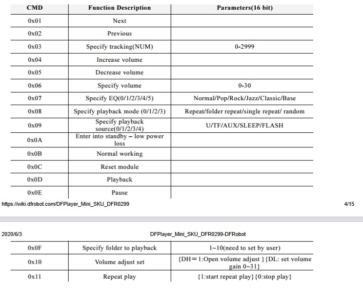

Hello All,
Would any please let me know about the use of this CMD code from left side column in figure below for DF player operation ??
FOR EXAMPLE :
Suppose i want to apply this repeat function to a particular song track and the code is 0x11
(last line in diagram)
Then how to write the proper script regarding that ??
Thanks !!!!!!!!!!

Ya, Please let me know any of the library for this . .
For now,
I have this library
"DFPlayerMini_Fast"
for pause and resume function for a song
Its working very well here . . . .
So please guide me further, as i am not able to find a proper pack !!!
Which other commands would you like to use and are you sure that they are not already supported by the library ?
The functions available can be found in DFRobotDFPlayerMini/DFRobotDFPlayerMini.h at master · DFRobot/DFRobotDFPlayerMini · GitHub
If you have that library, then looking at the github examples, you would have this line at the top of your sketch:
#include <DFPlayerMini_Fast.h>
The sketch you posted has:
#include "DFRobotDFPlayerMini.h"
I think this is the DFPlayer library that DFRobot has on their github site.
Have you looked through the library code to see if the command you want is already implemented?
Ya like with this library
only pause function is working but its not able to play or resume the file again
So only pause function supported, not the play function.

What happens if you use the library startRepeatPlay() function instead of the library loop() function ?
Does it cause the current song to restart immediately ?
Yes Yes Yes with loop function only the current song restarts immediately from beginning !!!!
Well,
Some Observations after practicals below :
  1. pause and play separately is supported by both the library
    DFRobotDFPlayerMini
    DFPlayerMini_Fast
  2. resume is member of
    DFPlayerMini_Fast
    but
    not the start
  3. start is member of
    DFRobotDFPlayerMini
    but
    not the resume
  4. loop(1) detects & starts the song 001 from beginning
    loop(3) detects & starts the song 003 from beginning
    and so on . . . . . . . .
    to get it under looping conditions for playing !!!!
  5. Unlike SD Card Module, the pause /play with single button is not supported by any of these
    currently implemented library.
    Don't know if its somewhere else present
