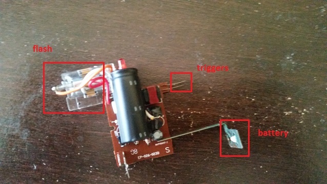

Hi guys,
So I got the flash out and have attached a picture, how can I possibly trigger this using arduino ? :~
question : do I need to have battery for the flash in or i can use arduino 9v source?

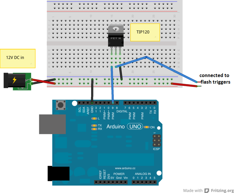

will this circuit diagram work ?
A TIP120 isn't a FET, is it?
What voltage did you measure on the flash contacts?
Is it safe to apply that voltage to your transistor (wherever it turns out to be)?
Use a battery for the flash.
When the flash fires a short high current pulse is generated.
Any common connection to the unit could destroy the arduino.
I suspect induced voltages but dont know except pyro mates experience.
As said previously they have experienced several fried chips.
AWOL:
Assume 200 V across the contacts.
You will NOT be able to measure this with a dmm.
An electrometer is required.
AWOL:
Thanks, yes to all 3 questions.
could you please assist me further ? I'm stuck.
Tip 120 is a darlington not a fet.
Max voltage is 100 v which is not enough.
Use an scr or a fet with a seperate protection diode.
You may measure i guess 50 to 60 v assuming a 10 megohm dmm.
The actual voltage will be 150 to 200.
To get the correct voltage you need to know the circuit and apply kirchoffs law.
If you identift the camera you are using get the circuit off the internet and post a link, then i will try to show you how.
Many have played with these and most have been reverse engineered.
A relay would be much simpler though.
