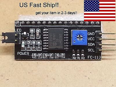

After you have answered those to your satisfaction you might ask yourself: - Do I have any other options besides the ICSP connector ? (ie: parallel to I2C backpack) like this one:

- Do I have any other options besides the ICSP connector ? (ie: parallel to I2C backpack like this one:)
(addresses are configured with solder pads)
FYI: I2C only requires A4 & A5 , because it is address based, not chip select based. The above backpack can be used for
up to eight lcds.
