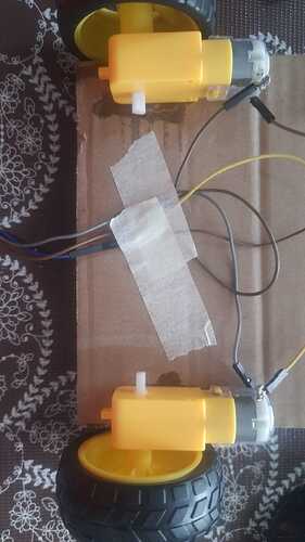

Please, post the picture of the motor you are using.
We don't see your motor.
Ok!
Those motors are designed to run on 3V to 6V, 12V is too much
Try using a 9V, 2A adapter for the motors.

It is still not working.
I have replaced the 9 and 10 pins, removed the servo library, changed the Arduino, changed the bridge, changed the power supply(5v,9v,12v) to both the Arduino and bridge, changed the motors, changed the code, and even used the self PWM method prescribed by @GolamMostafa. It still jerks and it is very frustrating.
You still have not answerd the question regarding current
How much current can the 9V and 12V power supplies provide?
