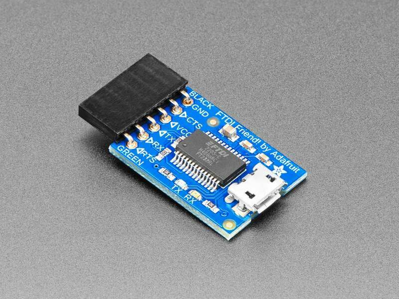

This one costs more than when I bought it years ago, but it is very flexible:
