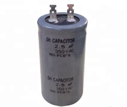

Right to the chase, induction heaters are awesome. But the capacitor selection is tedious. It seems that mkp capacitors are the best option. BUT,
What about these?
I dont see people mention these. Although electrolytic, they are quite big and seem capable enough to handle some current. I saw something about a low frequency /high frequency capacitor somewhere but google doesnt know anything about it..

These are not high frequency capacitors due to their method of construction. I very much doubt they would work and may explode.
Start and run capacitors may be mica, ceramic, porcelain, Mylar, Teflon, glass, or rubber, but not electrolytic.
If you would show your schematic and explain why you think you need a capacitor?

Motor run capacitors are film capacitors, not electrolytic, as they are AC capacitors designed to last for decades,
that's why they are so large.

Im sorry, i mistook it as a electrolytic, although i remembered breaking one a while ago and it was clearly a film capacitor..
I dont have a schematic on hand right now, but i am talking about the resonant capacitor in an induction heater circuit..

Film caps are much larger than electrolytics for the same capacitance and voltage. This is
the same as saying they have a much lower energy density.
I still dont get the high frequency bit that doesnt allow it to be used over mkp
And by size, i meant more heat dissipation ability.
That is not an electrolytic capacitor. BTW there is a special kind of capacitors (MKPH) designed speciffically to be used in HF high current applications. Use those if possible. And read datasheets. They usually contain useful informations regarding the capacitor's ESR, ESL and dissipation factor.

I don't know but you can get them on ebay or aliexpress I believe. It is aslo possible to use standard MKP caps, though. They may be less efficient but nothing terrible.
330n/630vAC/1200V MKPH induction heater caps are about US$1 on ebay, with free shipping.

Each type of capacitor has a maximum frequency where it will still look like a capacitor. Over that frequency it will look like an inductor. This is called the resonant frequency of the capacitor and it depends on the value and the type.
The other related measure of this is the ESR or Effective Serial Resistance of the capacitor, which how much capacitance reactance it has rather than how much simple theory would say the capacitive reactance is. Low ESR capacitors are needed in things like power supplies, especially switch mode ones.
