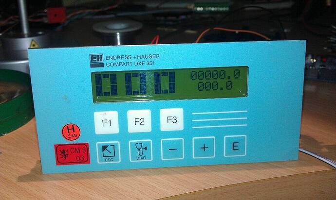

Hi(hope that I'm in right section), I want use "My Speedometer Project" from user ElectricWater http://arduino.cc/forum/index.php/topic,8790.0.html
I set everything alright, turn on the board and the project is working! yay! But after few miles everything freezes... Input don't work, button to change screen dont work, whole board is dead.
I tought restart will help, but no. So I uploaded another sketch to my board and everything is fine, works like charm. I uploaded back Speedometer project, and nothing, sketch is still dead. I took another arduino, uploaded sketch, it works(yay), few miles and dead. Could the sketch did something to the boards? Or there is a problem in that skech?

Now, I edited it.
And here is the sketch, same like from ElectricWater

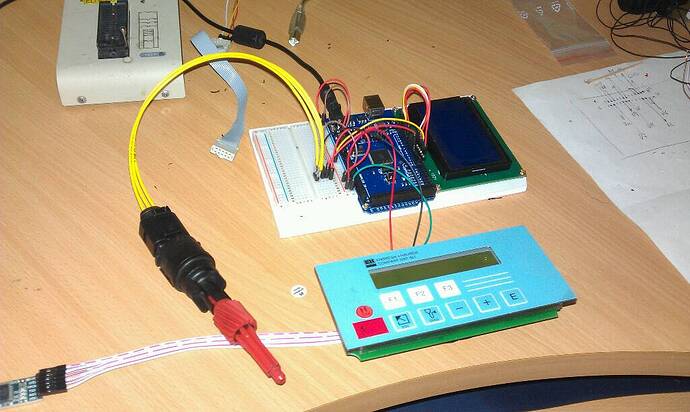

Let's see a schematic of your connections to the vehicle. You need to protect the inputs and the Vin from the car's electrical system.
I havent connected it to car yet, but I'm using Hall Sensor from VolksWagen
Jirka10:
How are you driving it "miles" to test it? I'd still like to see how you have the sensor connected.
Look at photo, and in the sketch there is output for testing. And the sensor is from gearbox...
btw. I have Mega1280 and Mini328
Ok, I can't see whats on the protoboard where the sensor plugs in. Can you point to a link that shows how this sensor is wired? Is it an open collector output, or is it magnetically generating pulses thru a coil? If it's the later, then that's what is smacking your boards. You need current and peak voltage protection on the input pin.
Sensor has three outputs. + - and rectangular signal whose frequency changes by the rpm in gearbox
Are you applying 12V to the + connection of the sensor? If so, then that's the problem. This came right out of the article you referenced:
"For power I'm running off the vehicle's battery, but I did take some protective measures. There's a dedicated line that connects very close to the battery itself, which from what I understand makes a pretty significant filter. I plan to use a key-on powered relay in the future, but for now I just plug in the PCB when I'm going to drive somewhere. I also have a simple overvoltage/overcurrent protection circuit that I constructed in the power cable:"
EDIT: I realize this is talking about the power connection, but the same applies to the input pin. If you have a 12V square wave coming out of the sensor, then it is quite likely that it is damaging your boards if you don't put anything in-line to limit the current and voltage.
Ahhhh, and what if im using test pin, from the sketch?
And the sensor is powered with 5V from Arduino Mega and the sensor is givin 5V pulses

I'd still be tempted to look at the signal and make sure no large spikes are present.
Ok, I will, but if I try another sketch boards looks pretty well, and if I write mileage manually to EEPROM it will show on the display.
Jirka10:
Have you verified that the actual I/O pin that is connected to the sensor is still working fully? You can "kill" portions of an individual pin. Fortunately, you would only have to replace the 328 chip (assuming you have the thru-hole part) for a few bucks to repair it.
Yes, I have. And when I use another sketch on same pin, everything works fine.
Well, either the pin is damaged or it isn't. It's not possible that it stopped working with your sketch, yet works with other sketches. Either your sketch has a bug that you don't see, or the pin really is damaged in some fashion. Like I said, you can damage "part" of the functionality of a pin without killing everything that it can do.
If it is damaged, then it seems apparent that it's the sensor causing the damage some how. Therefore, you need to examine the output of the sensor on a scope if you can, and you need to apply some kind of input pin protection. If you plan to install this in a car, then you will absolutely have to provide protection for the board. Don't just connect it to a "convenient" 12V source, you will end up damaging a lot more than a pin. Without some kind of dampening, your board is likely to see 50V surges on the power or even reverse voltages are possible. Just do some research, there is a lot of good info out there.
