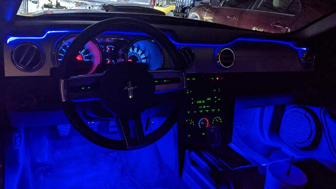

So I want to use RGB LEDs as interior ambient lighting in my car. It currently have footwell, dash, and backlit cupholders, but I want to manually control what color is displayed at night. As far as I'm aware, you can only carry out one setup and one loop function through an Arduino which simply translated means I can only have it display one color or animated sequence while booted up.
My real question: Is there a way I can setup a momentary button to cycle through different loops/functions to change to preset LED colors/animations? The FastLED library that I'm using uses void loop to carry out LED sequences or simply continuously display a color/colors. Any input to help me with this project is greatly appreciated!!
Below is an image of areas of LEDs I want to control:
Yes, but the animations must not block reading of the input which in practice means no for loops, no while loops and no delay()s in the animations
Reading the input button is easy but you need to detect when the button becomes pressed rather than when it is pressed
See the StateChangeDetection example in the IDE

Firstly there is no such thing as a "void loop". The term "void" is a qualifier - it selects how the following function - "loop" is one such function - behaves in respect of whether or not it returns a value directly when called. "void" means it returns nothing.
Secondly, the "NeoPixel"s require no data to hold their colour, you only "refresh" the data to them when you need to change their colour - and you have to refresh all of the pixels every time so the term "individually addressable" is somewhat of a misnomer.
So a sequence of changes requires code to send a complete new pattern - even when some or most of the pattern is the same as the previous - on a timed basis in order to animate it. How libraries do this will vary and some (perhaps most) will tie up the processor, internally using delay() while they complete the pattern sequence. This is a specific limitation of the library, completely unrelated to the "loop()" function.
Overcoming this requires using library functions only to implement single pattern steps so that your code can make the decisions to take the next step or if the button has just been pressed, to change to a different pattern.
The FastLED library doesn't use loop(), it's the other way round: loop() uses the FastLED library.
By changing loop() you can make the LEDs do whatever you want. For example, you might store the pattern for eight different colours in your program, and when the button becomes pressed, it moves on to the next pattern in a circular fashion. When the button remains unchanged, no new pattern is sent, so the LED colour remains the same.
That's the basic approach. Study the code you've got to see how the colour is controlled, and also take a look at the State Change Detection sketch in File | Examples | Digital.
