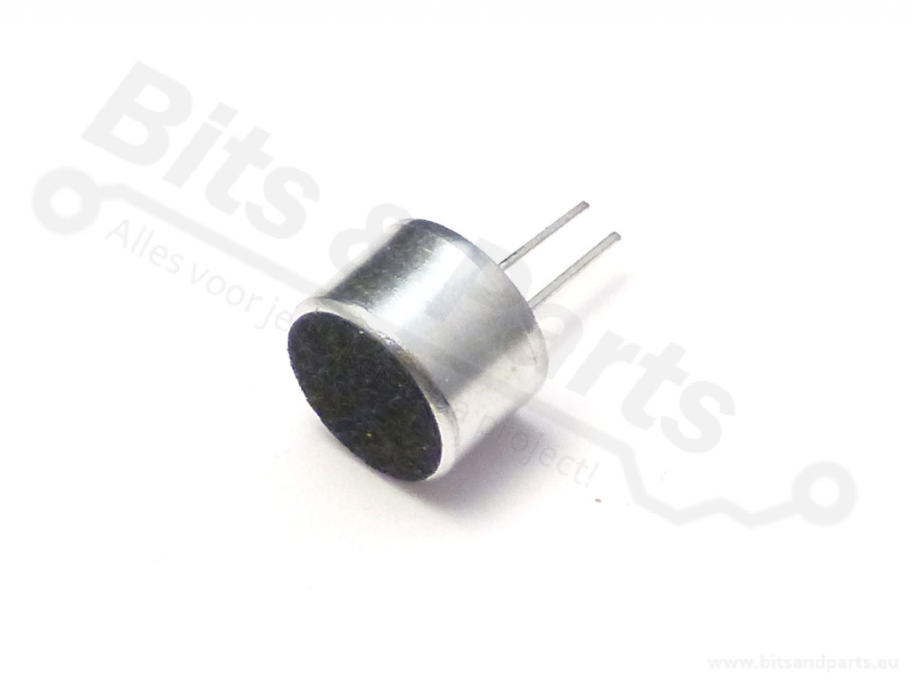

Im trying something simple.. just hooking up a microphone to my arduino to check some (sound) waves. I bought this little fella
which I want to connect.

Lets take the microphone as an example, here are the specs of the mic
It should provide me with all the information I need, but I dont know how to determine from this the amount of resistance I should provide.
Besides.. the given electret microphone says it need 1,5V and a current of 0.5mA. I know my Genuino provides 5V and around 40mA... so can these numbers give me some guidance on how to choose the amount of Ohms I add?
The specification sheet says to use an external resistor of 680 Ohms.
You will need an amplifier to make use of that microphone. There are a variety of convenient microphone modules with one built in, like this one.

Thanks for the info, but are you certain that those are the right amount of Ohms? If I look at the sketch correctly.. then I would need 680 Ohms if I have a power supply of 1,5V. Or am I reading it wrong?

I would go with what the spec sheet recommends:
Omni-Directional Foil Electret Microphone, 9.7 mm diameter and 4.5 mm high, Power Supply 5.0 V max, External Resistance Loading of 680 Ohms, and sensitivity of -44 dB.
But you will need an amplifier.

The instructable uses a BJT common emitter stage with no negative feedback, precisely because it has a very high gain. Not what I would use, though...
