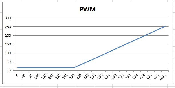

I'm wondering if it's possible to put limits into the map fanuction.
If I use this;
val = map(average, 0, 1023, 15, 255);
The output will look like this,
However what I really need is this
I have modified the map like to look like this,
val = map(average, 0-400 , 1023, 15, 255);
and to my surprise it verifys but I can't actually test it yet.
Will it work in a Nano or do I need to set the lower limit another way?
Many thanks, Rich.

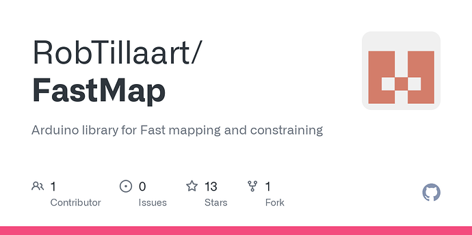

Have a look at my fastMap library. It is developed for floats and the performance for integers is worse on some platforms.
It implements exactly the functions you need: lowerConstrainedMap().
Give it a try
Indeed lowerConstrainedMap from @robtillaart's library is perfect.
