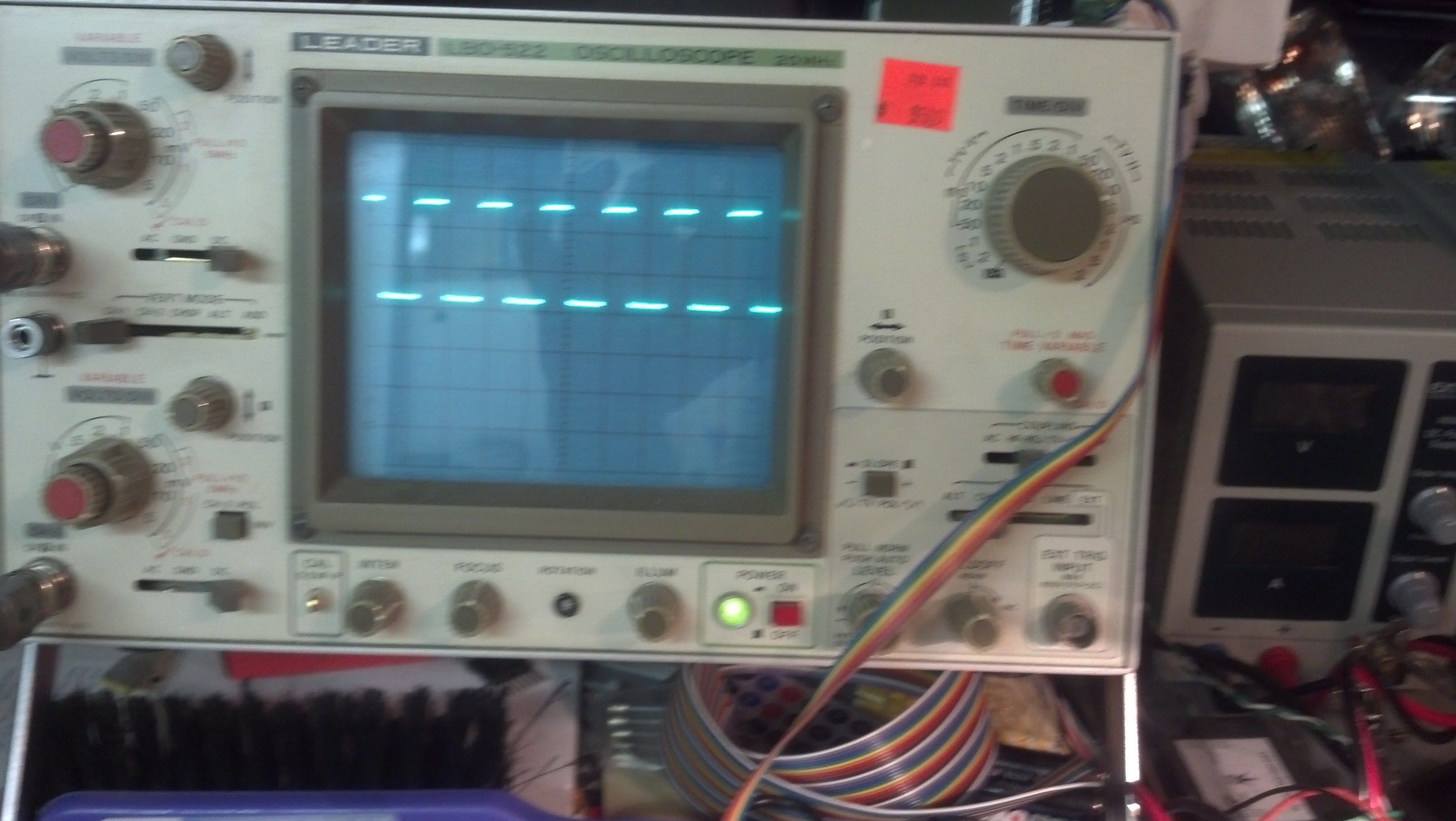

This sketch is for an ATtiny85 (NOT AN UNO) and generates a PWM signal at PB0 (IC pin-5) 38khz that varies the duty cycle based on the analog input at ADC1 (IC pin-7)
The ATtiny85 is a $3 8-pin IC that can be programmed by an UNO in Arduino as ISP programming mode.
I tested it with a scope and the frequency is 38khz with a duty cycle that varies 10% to 90%.
You can comment out the analog input code lines and uncomment out the FOR loop which continuosly varies the duty cycle as an example. The duty cycle is set by the    OCR0A =1475 ;   // CTC Compare value (count up to 1475) //
statement and in Setup and then later varied by the analog input MAP statement. (and also by the FOR loop)
The ATtiny85 is an 8-pin IC.
The board file for THIS sketch is 16 Mhz Internal PLL , 4.3V BOD
You have to use Burn Bootloader to set the fuses otherwise it will not run at 16 Mhz.
The analog input is applied to IC pin-7 which is ADC1 . The 38khz PWM is output at IC Pin-5 (PB0)
If you look at the attached scope photos, you can see that in all three cases of duty cycle , the period remains about 16 uS.
If you want to learn how to program an ATtiny85 with an UNO there are numberous tutorials on the web, most notably the MIT one.
