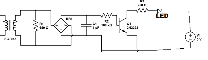

I want to use a current transformer to trigger esp32 input ( negative active ) this is my schematic
this circuit works fine and led is lighting when load is on now I connect it to esp32 gpio as
a switch to connect the input to negative
this is connection digram

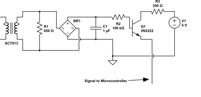

Something like this will work. Do not expose the ESP32 inputs to voltages higher than 3.3V, and be sure to connect the grounds.
If the AC current is ON, the output of the 2N2222 will be LOW.
Capture
Because your circuit only pulls the input up to 5V (which is too high anyway and will damage the input), there is nothing to pull it down to 0V.

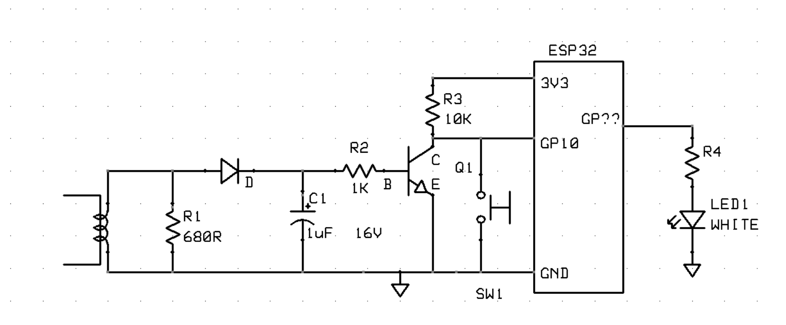

After disassemble and assembling again your modificatiom works but the gpio vibrating between on and off for half second while the load is on
I draw the circuit power from esp32. 3.3v pin
The bridge rectifier BR1 is a poor choice for that circuit, because of the excessive voltage drop. Try using a single diode to rectify the CT signal.
See this study: YHDC SCT-013-000 Current Transformer — OpenEnergyMonitor 0.0.1 documentation
I remove bridge and put one diod instead but gpio stil vibrating on and off

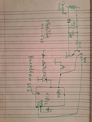

Can we please have a circuit diagram?
An image of a hand drawn schematic will be fine, include ALL power supplies, component names and pin labels.
This is diagram
The esp32 powered from usb port connected to a power bank
The transistor powered from esp32 3.3v pin and grounded to gnd pin
You might get better results with this configuration.
In your circuit the diode was the wrong way around.
The diode needs to be after the burden resistor.
To make the BJT conduct you must have the base of a NPN BJT positive with respect to the emitter to make the base-emitter junction forward biased.
Check your circuit. Especially the BJT pinout.
