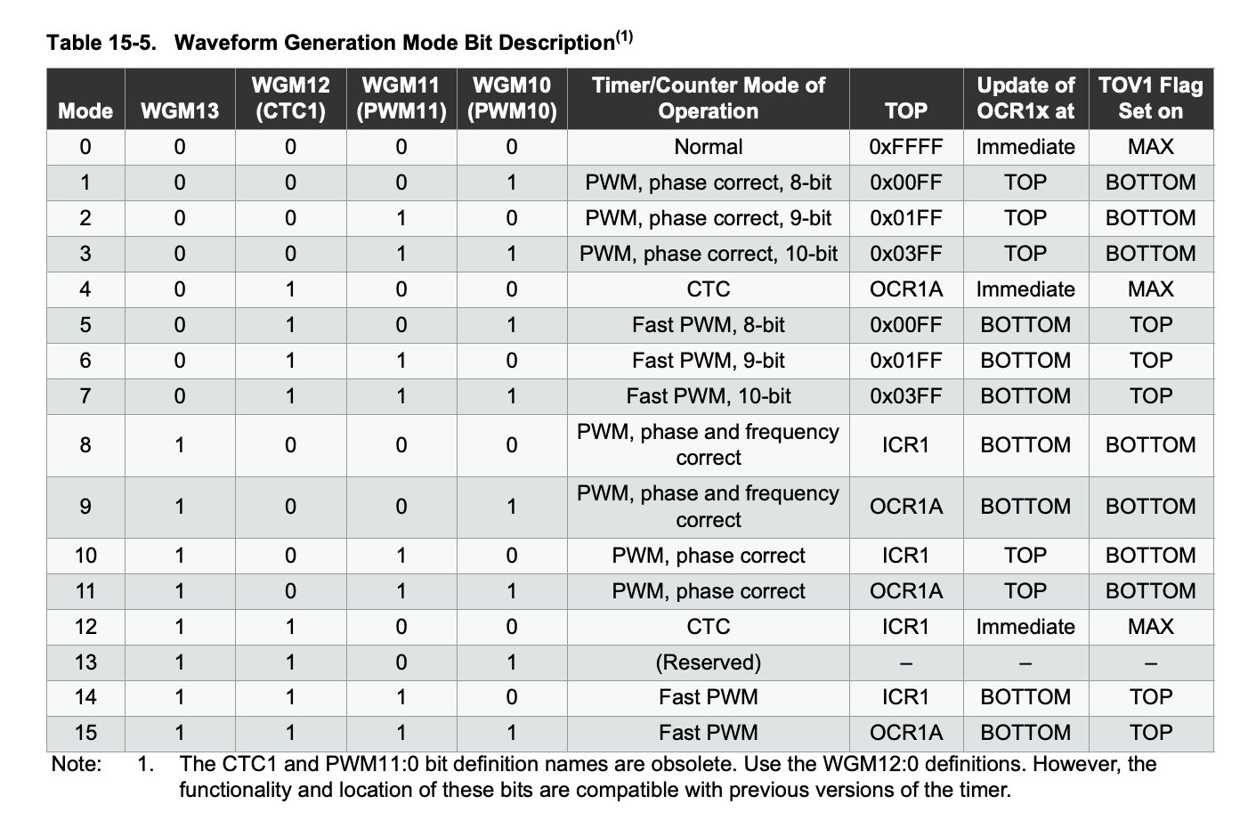

I don't think you timer mode setting of FastPWM to OCR1A is correct.
From the data sheet
The ICR1 Register can only be written when using a Waveform Generation mode that utilizes the ICR1
Register for defining the counter’s TOP value. In these cases the Waveform Generation mode bits
(WGM1[3:0]) must be set before the TOP value can be written to the ICR1 Register.
Based on this, you should be using WGM mode 12 (1100) or 14(1110).
OP's using WGM mode 15 -- Fast PWM with TOP=OCR1A=50000
12 or 14 would use ICR1 as top, and then ICR1 wouldn't be useful for input capture.
I want fast PWM(pdf line15). I want to set the needed lenght of period(OCR1A) to fit the inductiv response. ICR1 must not be used in PWM settings. It has to be free, that can be used on interrupt event on comparator, whitch trrigers timer1 and then captures current counter value of timer1 in OCR1 register. It is tricky mechanisem that only timer1 in connection with comparator interrupt enables. Comparator is using one input for internal reference 1.1V and on the other input is coil respons which triggers event, when signal falls below 1.1V.
You are correct. I was confused. I think it is more common to use Normal mode with top value 0xFFFF instead of a pwm mode with a different top.
OCR1B is used to set the lenght of pulse to excite the coil. It depends on current on the coil I want to reach.
