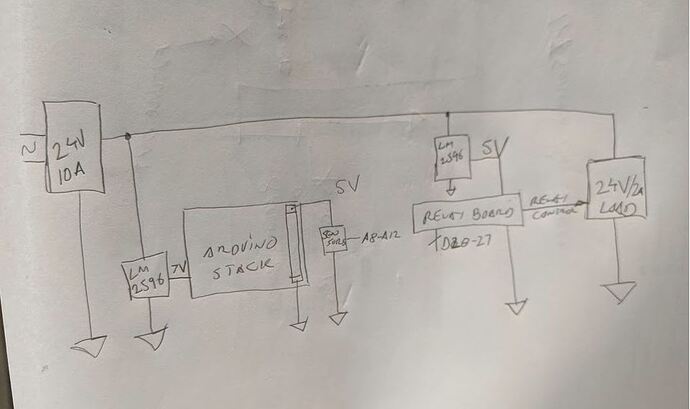

I'm adding the block schematic below:
I have a 24V/10A DC supply, which is needed to drive some ionization electrodes (about 2A).
The Arduino Mega won't take 24V, so I'll use a separate Buck converter 24-6V(or so) to supply the Arduino Stack and the sensors.
And I'll use a separate Buck converter to supply the 8 Relay Board, to make sure I don't get variations as miscellaneous relays turn on and off.
The LM2596 Buck converters are 2A continuous rated.
Cheers

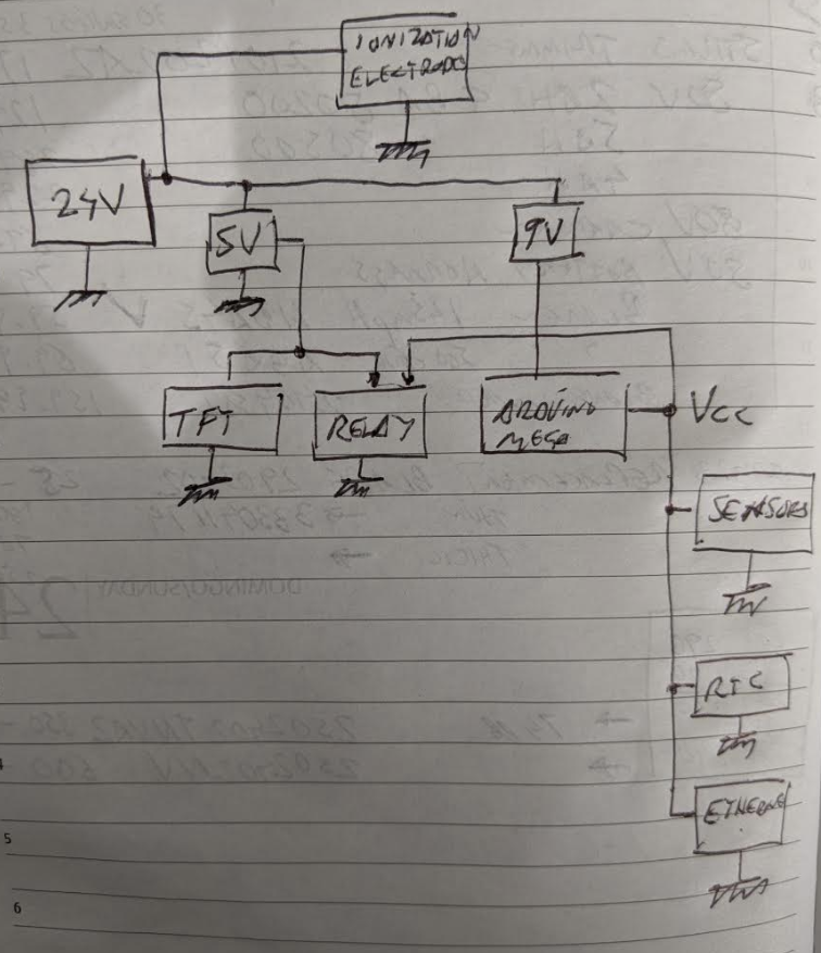

Greetings;
I continued with programming and at one point was ready to unplug the system from the computer and let it live its own life.
So I plugged in the power as in the schematic (can't call it sketch in this community ;D ) of the previous post. Within 4 minutes, the screen went blank, without a single Relay activated
Further investigation revealed a piping hot 5V reg on the Arduino, caused by the excessive current of the TFT screen (likely backlight).
So, I rewired as in schematic attached to this post:
24V supplies two buck converters, set at 9V and 5.1V.
5.1V supplies TFT screen and Relay Coils
9V supplies ARduino Mega
Arduino Vcc supplies Sensors, RTC, ethernet Shield and the Relay board electronics behind the opto-Coupler.
I then ran test, flipping all relays on/off, observing the various supply voltages: Fluctuations of less than 0.002V.
In operation for several days now, stand alone, measuring, communicating, displaying!
Case closed!
Thanks for your help.
Why are you proposing to persist in attempting to power the Arduino via "Vin"?
It requires 5 V. You put the 5 V in through the "5V" pin using a 5 V "switchmode" converter so that all the internals get the full 5 V and you connect the same supply to whatever sensors and other parts use 5 V.
That is how you power it and you will have no trouble with how many things the output pins are trying to supply other than the limits specified for the microcontroller chip itself.
There is some concern that powering it at 5 V might cause trouble under some circumstances, to a PC connected to the USB port. So when you program it, either disconnect the "5V" pin when you do so or use a modified USB cable with the 5 V wire disconnected.
Given that it has the opto-isolators it is a good idea to power the relay board from a separate "buck" converter and ensure the ground of the relay bard does not connect back to the Arduino, only to the "buck" converter.
Thanks Paul,
That might work too.
I do have an external USB connector on order anyway. I'll just connect the two data pins and solve the potential conflict.
I'll drop the Voltage from 9 to 5V and switch from Vin to Vcc...
Why did you specifically mention switching supply vs buck converter for the supplying the Arduino and sensors?
Cheers
trilife:
I was distinguishing between providing power in a single step from the mains versus using a power supply providing 12 V and then using a switchmode "buck" converter to drop that to the necessary 5 V.
Complicating it by taking two step-downs makes little sense unless the intermediate voltage is required for some other purpose which you do not seem to have indicated.
I also stress the use of switchmode converters which are efficient at each stage, as against series linear regulators which produce much more heat which you then have to manage.
Got it.
Yes, I do use a switching supply for 20-24V DC to drive some ionization electrodes, controlled by the relays. A buck converter then drops the voltage again to 5V...
Cheers.
