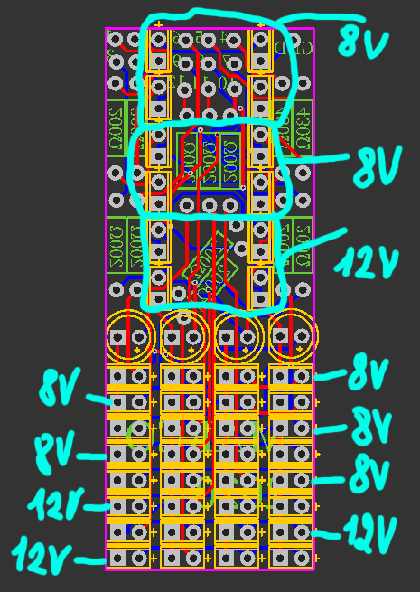

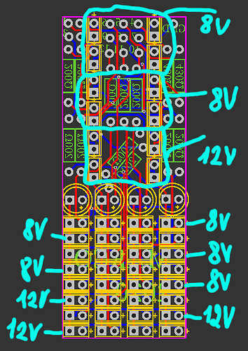

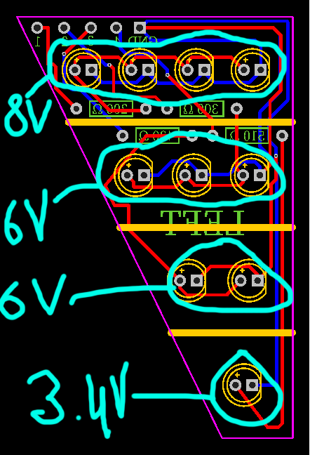

So here's the the first PCB schematic. I've circled each group and written the voltage needed. I still haven't put a ground plane because I don't know if it's a good idea.

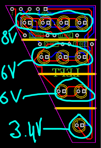

Here's another one above that is a bit more complex to read and for which I also don't know if I should do a ground plane :
One last thing: I know the resistor values aren't correct, I still have to correct them. Also, everything is already routed and should work.
I forgot to say that each group needs 20mA to work
HI,
Sorry but we need schematic, not the PCB pattern.
I gather you are making automotive light clusters?
At first glance those LEDs look like they're in parallel not series...but a proper schematic should make it clear.
If the LEDs in a group are in series then obviously you CANNOT connect all of either the anodes or cathodes to the same place. That makes no sense at all.

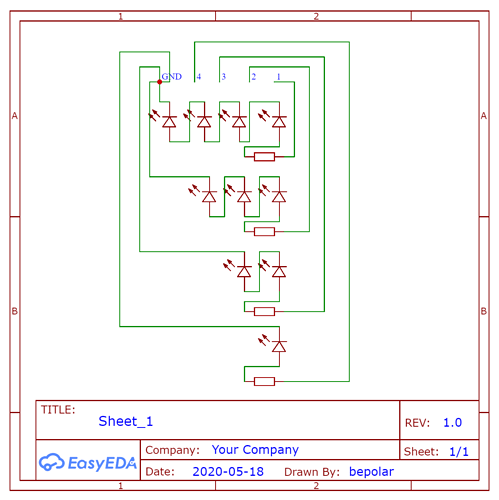

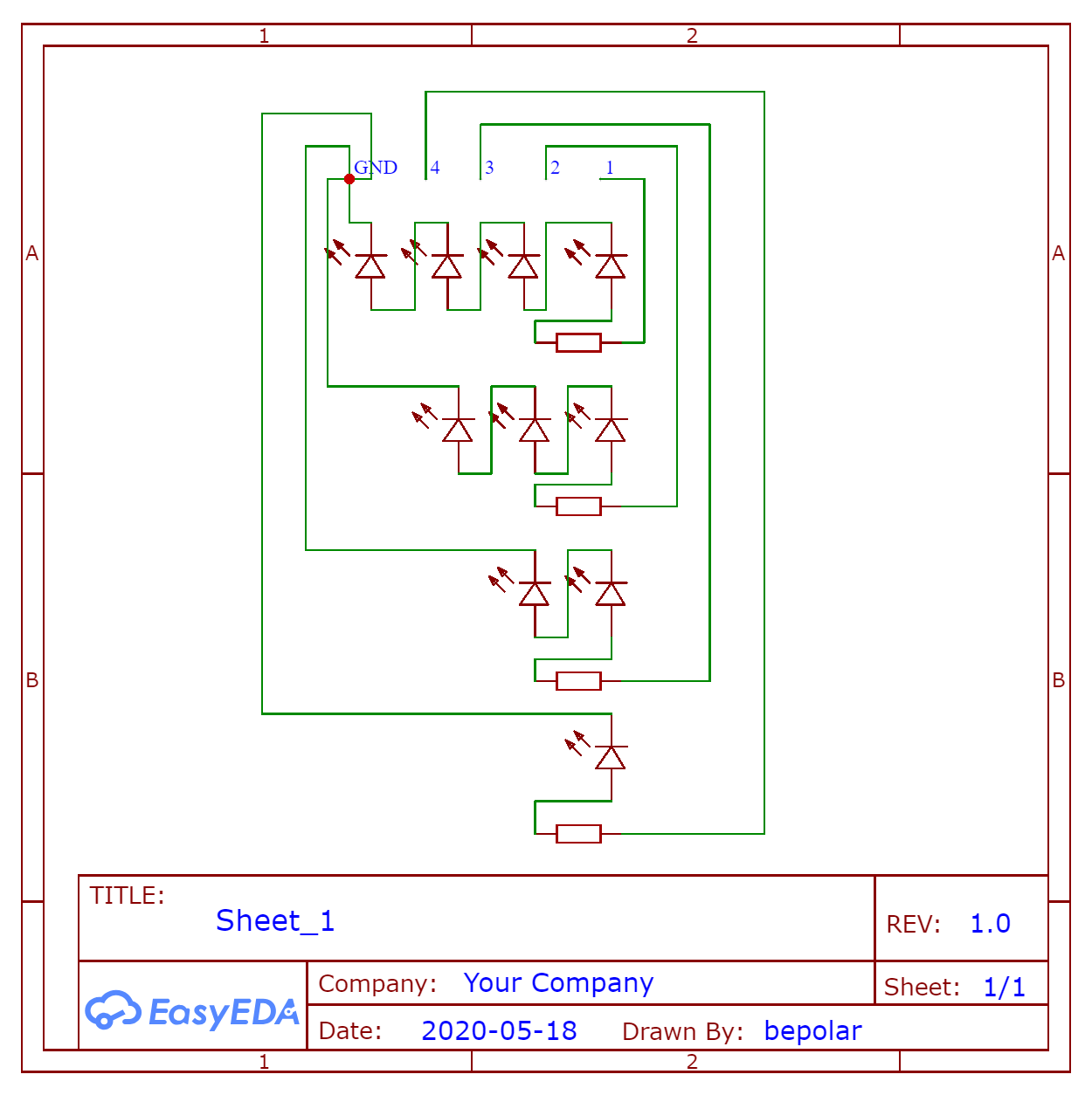

So here's the schematic. I precise that I've routed the cathodes but what I'd really like is to connect all of them to a ground plane (if that's possible, obviously)
No
Do not connect your LEDs is parallel.
Why should I do that ? (it's not that I don't believe you, but I just want to understand)
I was assuming you wanted the ability to turn the LEDs on and off, if you don't then you don't need the MOSFET.
Your schematic shows LEDs in parallel, that won't work, LEDs should be in series.
Just to be clear - what you want to do is just to switch GROUPS of LEDS on and off.? Not individual LEDs and not any dimming etc. Just on/off. Is that right.
Anyway what you have so far is parallel connection and connected that way the voltages DO NOT add up but the current does. So a group of 4 would take 80mA and that's way too much for a digital pin. So you would need MOSFETs. And even if you do connect in parallel like that then you still need a series resistor for EACH LED not one for a group.
If you connect in series (Cathode of one LED to Anode of the next and so on) then the voltage adds up, current stays same and one resistor per group will work. But then you'll need more voltage then you can get from a digital pin so you'll need MOSFETs again and this time high voltage source.
It's probably a good idea to learn a bit more about what parallel and series actually mean and how that works out for LEDs before you go any further with this project.

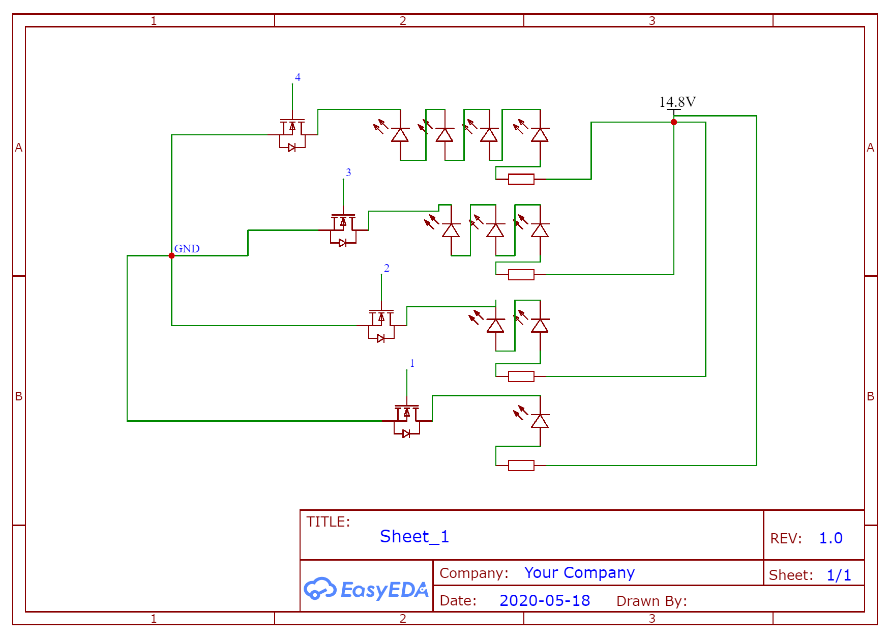

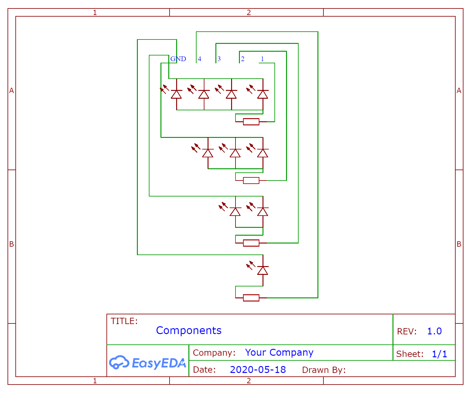

Oh sorry, I just realized I've made a big mistake. I knew how the principle of series and parallel connections worked, but I didn't know that the anodes had to be connected to the cathodes for series connections... It's obvious to me now :o
So yes, what I want to do is to be able to just turn on or off each group of leds independently. That's why I planned to use a "high voltage" battery (14.8V) with transistors to power the groups with simple arduino pins. (Tell if I'm wrong but I'd gathered the transistors might be better suited for that kind of circuit than MOSFETs)
So my question is if, despite the different voltages needed for each group, can we still connect all the cathodes at the end of each group to the same ground plane?
Here is also the new schematic that should be correct (don't hesitate to confirm me if it is correct now :slight_smile: , always knowing that even if I have already routed everything on the schematic, I would still like the ground routing to be done from the ground plane, if possible)

That will work fine.
And you of course know the series resistor gets smaller in value as you add a LED to a string.
(Vcc - V(led_total) / .02A = R(series)
(14.8V - 2.2V(red LED) ) / .02A = R
~630 Ω @ 1/2 watt should be good.
560 and 680 are standard values.
Yes, but as I might have mentioned before, it's better if you put the transistor between ground and the cathode of the bottom transistor and connect the anodes to the positive supply via their resistors.
You're wrong. Use an N channel MOSFET wired as I suggested above.
Bipolar junction transistors are last century's technology, MOSFETs are much better. You put them in the ground circuit because they are easier to control that way.

Actually, suggest you wire as common anodes.
This will allow keying the cathode side to GND later as needed with a BJT/MOSFET.
If you do things as in your schematic, you will not have an ‘easy’ option to key the anodes later.
Take a close look at the two circuits in the 2nd image of post #1
The left circuit is a ‘low’ side switch, common anode, the right image is a bit more complicated ‘high’ side switch, common cathode.
I think it's time you produced a new schematic taking into account the advice you have been given and show us what you have. I am finding it difficult to know what you have understood or misunderstood and a new schematic will clearly show if you are on the right track or not.

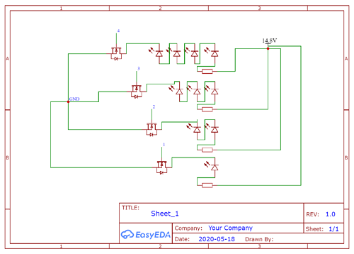

Hello,
Here's a new version of the schematic.
larryd:
I'm not sure I understand what you meant by common anodes. I took a close to look at the schematics you've shared but when I googled the term 'common anodes', I saw that this technique was used for 7 segment displays and that kind of stuff, so I don't understand what this kind of wiring could bring to the schematic?
Also, would that be possible to wire the mosfets as a high side switch. I know that it's what you've done on the schematics you've shared but I've been recently told that we could'nt do that (at least with BJT) but I don't know if it's true.
