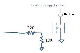

No turning one way is good enough for me. And I also found a video onyoutube of someone using a MOSFET do you know if it is possible to use multiple of those in case I have to make them turn two directions?

Yes, need 4 MOSFETs per motor to turn in both directions.
Two more NPNs also if the motor supply voltage is more than 5V.
Use parts with Logic Level gates (vs Standard (10V) gates) if supply voltage is < 10V.

In that case you just need one mosfet per motor.

The circuit you have will work for DC motors, but a MOSFET as described earlier would probably be better. Your relay circuit would also work with AC motors, except that you would want to completely isolate the AC power paths from the DC control paths. As it is drawn now, the motors use the same power supply as the Arduino, you would need to make sure there is no connection from the AC motor supply to the DC Arduino supply.

I would still use a separate power supply for the motors and the Arduino. Hook up the power to the Arduino like you normally would. Then connect the negative side of both power supplies together, they should be connected connected to the Arduino ground. Finally, connect the positive side of the motor supply to the top connection shown in KenF's MOSFET diagram.
