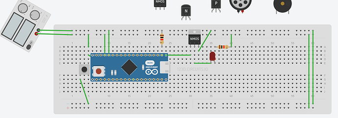

Hey,
Thanks for the responses! and I've attached a new schematic where I think I've removed the short to the Push button? Along with that, there's no tracks under the Arduino now. I've also added a resistor to connect pin 5 and GND. When testing online, its still having the same issue as before though.
Maybe not. Try it with the jumper I've marked* removed.

Just tried it and unfortunately it didn't work at all. My understanding is that a switch needs a complete circuit which then spurs off into the arduino to provide in the input.
Weirdly, this all did work before I tried using the MOSFET component and I copied the Nano circuit in the link below.
https://translate.googleusercontent.com/translate_c?depth=1&hl=en&ie=UTF8&nv=1&prev=_t&rurl=translate.google.co.uk&sl=auto&sp=nmt4&tl=en&u=https://www.heise.de/ct/projekte/machmit/processing/wiki/AufbauArduino&usg=ALkJrhhwNA265I57apW5tHu8FoSXxIq_iw
Solved it! my silly wiring around the push switch was the issue. Copied the example in the link exactly in regards to the push button and its working perfectly.
Thank you all for your help! and I'm sure I'll be back with more questions.

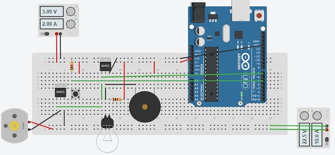

Hey,
Knew I'd be back pretty quick! So the circuit and code all works now but as I want to add a recoil solenoid into the mix, I've breadboarded a motor in as a substitute for the time being (see the attached image).
The solenoid would be 24v so in the simulation it requires a different power supply. However, when I follow the same wiring principles as the rest of the system and the pin on the arduino outputting to both gates on the MOSFETs, the motor won't spin? I've tried diodes across the motor terminals, resistors in various places, etc, etc but no luck.
As always, any help would be greatly appreciated!
The ground rail on the top of your breadboard is not connected to the ground rail on the bottom.
That layout needs some serious work.
PaulS:
Thanks! all works now. I'm just using tinkercad to test the waters. The tangible installation in the old PS4 light gun I'm using will be far worse.
