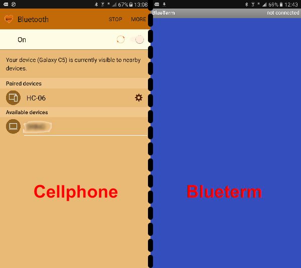

I'm trying with Blueterm and Bluetooth Terminal but even though my cellphone can see the bluetooth module HC06 (and my computer), the apps doesn't see anything.
briandu64:
No surprise there. If you look at the top right corner, you will see that it says "not connected". This implies that you need to make the connection. Pairing is not connecting, it is merely saving the address. There is comment on this in the notes.
if I want to connect, I must be able to see other devices and choose which one I want to connect to.
Correct. You do that with the connect option in the terminal menu.
