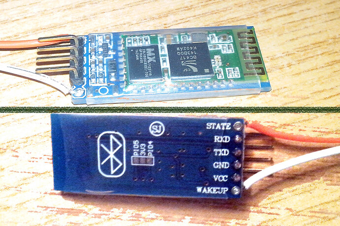

I just bought a bluetooth module (hc-06) . I've connected it to arduino micro and no communication ]:slight_smile: . RX->TX and TX-RX. Vcc to 5V and GND to GND. The bluetooth is mounted on another board with voltage regulator, an LED and some rezistor ready to be connected to arduino (I guess). I can connect with an android smartphone to it, but nothing.
When I connect, the led stop flashing but arduino do nothing at my inputs.
The module has 4 pins (vcc,gnd,rx,tx), in datasheet say that when is not connected to a device is in AT mode.

Check ther solder connections on the backboard, and make sure there are no bridges
FIXED!!!!!!!!!
The problem was the code :sweat_smile:
!!! REPLACE: Serial with Serial1 !!!
IF YOU HAVE ARDUINO MICRO OR LEONARDO OR ANYTHING ELSE THAT DON"T HAVE A CHIP FOR SERIAL-USB CONVERTOR, THAT CHIP IS VIRTUAL AND YOU NEED TO USE FOR RX AND TX PIN THE "Serial1" CLASS not "Serial".
I've found this when I search in Arduino Leonardo documentation, It say:
"-Serial: 0 (RX) and 1 (TX). Used to receive (RX) and transmit (TX) TTL serial data using the ATmega32U4 hardware serial capability. Note that on the Leonardo, the Serial class refers to USB (CDC) communication; for TTL serial on pins 0 and 1, use the Serial1 class."
