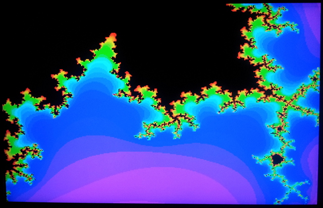

After working out how to do a timer interrupt I've had a go at making a VGA framebuffer. It is rather low-res at present(160x240) and fuzzy but I hope to be able to improve that. It has 8-bit colour (RRRGGGBB).
I cannot get Eagle to run right now so will have to describe the schematic in text: Due pin 2 -> VGA pin 13 (HSync) Due pin 3 -> VGA pin 14 (VSync)
Due pin 25 -> 820R resistor -> VGA pin 3 (blue) Due pin 26 -> 390R resistor -> VGA pin 3 (blue)
Due pin 27 -> 2k2 resistor -> VGA pin 2 (green) Due pin 28 -> 1k resistor -> VGA pin 2 (green) Due pin 14 -> 470R resistor -> VGA pin 2 (green)
Due pin 15 -> 2k2 resistor -> VGA pin 1 (red) Due pin 29 -> 1k resistor -> VGA pin 1 (red) Due pin 11 -> 470R resistor -> VGA pin 1(red)
Due pin GND -> VGA pins 5,6,7,8,10

I unrolled a loop and now it is 320x240 8) The resolution could go higher but 320x240x8 is 77Kbytes of RAM already.

vgaout2.jpg|640x413
:open_mouth:
stimmer, you've got some serious skills here! nice work!

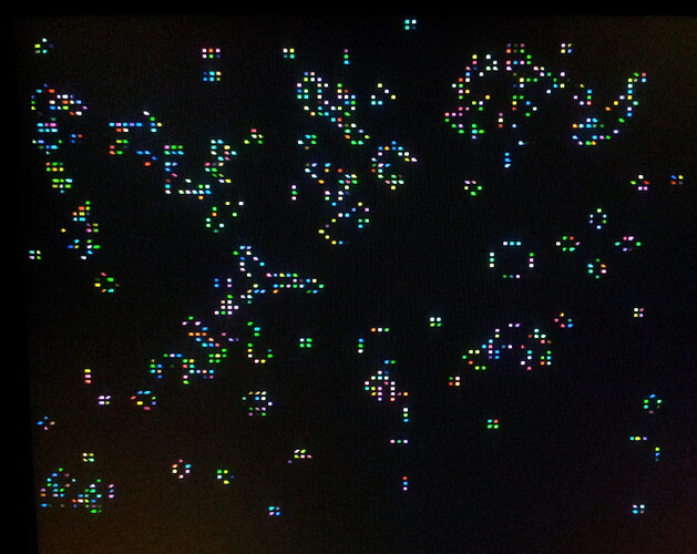

Simple Game of Life example :-)

JLS1: Simple Game of Life example :-)
Nice work :D (I accidentally left it running all night, it's still going strong!)

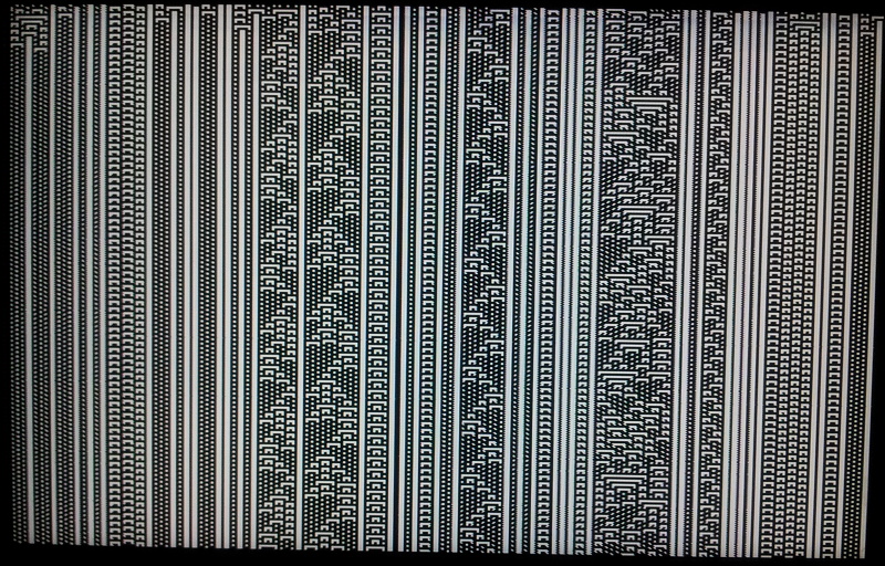

Simple Wolfram 1D Cellular Automata example :-)
/* Wolfram Cellular Automata 1D v1.0 */

Attached are some screenshots of JLS1's demo programs. Chua oscillator has my modification for colour. Life is Conway's famous 'game' we all know and love.
Cellular automata are explained in Wolfram's 'A New Kind Of Science' chapter 6 - he classifies them into four main types (uniform, structured, random, and complex) and others which are rarer and hard to classify. Attached are two examples, cell2 is complex and cell1 is one that doesn't fit the main types.
