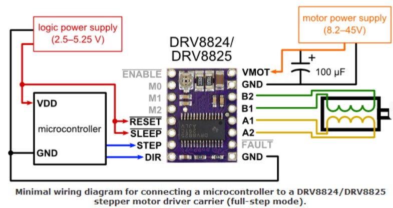

The Pololu DRV8825 web page has a good wiring diagram. I don't see a large capacitor in your picture.
Sorry, I can't make sense of the wiring in your photos. Just make a simple pencil drawing and post a photo of that.
The Pololu page also explains how to set the current limit. There is a special reference point on their boards for measuring the voltage. If your board is different please post a link to its datasheet.
Also, post a link to the datasheet for your motor. There are hundreds of different Nema 17 sized motors.

You have to make sure that you wire your drv8825 as follows:
Important: don't forget the connections of the sleep and reset pins of drv8825 (to VDD = +5V of Arduino)

It is mandatory to have a capacitor in your circuit that is wired to both Vin and GND terminals. I had the same problem with this DRV8825 driver (stepper produced squeaky sound, but did not rotate) until I added a capacitor as rpt007 showed with the hook-up diagram.
Just in case, here a nice guide for adjusting the potentiometer, where you can see the wiring of the driver to the microcontroller.
And also some explanation for the necessity of a capacitor (from http://www.instructables.com/id/Stepper-Motor-Module/?ALLSTEPS):
" If you like the electricity-as-water analogies - your motor going on and off and moving is going to create a lot of waves and the capacitors act as mini-flood planes to help smooth out the flow. 10 uF for the motor side. 1 uF for the logic side."
Note that it is recommended to use 100 uF capacitors with DRV8825 driver (look at GitHub - laurb9/StepperDriver: Arduino library for A4988, DRV8825, DRV8834, DRV8880 and generic two-pin (DIR/STEP) stepper motor drivers or the image of the circuit that rpt007 provided).
Have fun)
For a motor supply 100uF is the bare minimum decoupling - more if you can.
