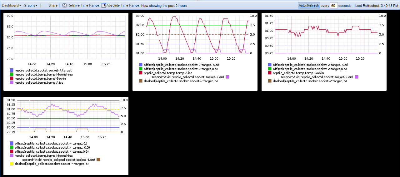

I have published the code of my vivarium controller using Arduino Yun, DS18B20 and 8 way relay controller. This chunk is the Arduino Sketch, I am working on preparing the linux/OpenWRT side for publishing too.
Unlike the previous version which had a local LCD and keypad, this one uses REST API via YUN bridge to effect control and read sensor values. It logs to collectd on the OpenWRT side, which forwards to an ASUS Chromebox I have flashed with Ubuntu. There the collectd server publishes the data to the Graphite dashboard application.

The linux side runs collectd which polls the REST API on the Arduino to retrieve the sensor readings and to publish them. This is in addition to handling the ethernet and bridge for the REST api, of course. I also have some patches to enable the arduino REST API to be exposed with "Access-Control-Allow-Origin" set correctly, although they need some cleanup which I've not yet had time to do.

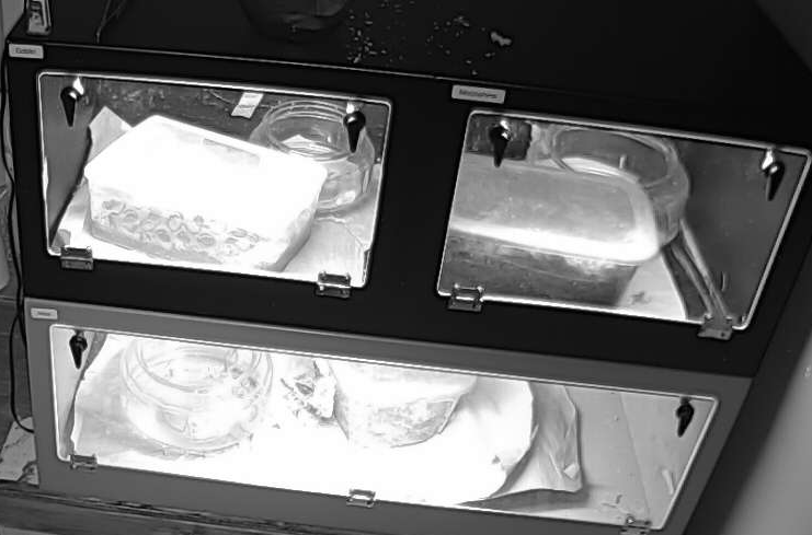

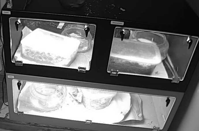

Here's a picture of the first three snakes. Unfortunately they're nocturnal and sleeping at the moment, I'll try to get a better one once they are active.
